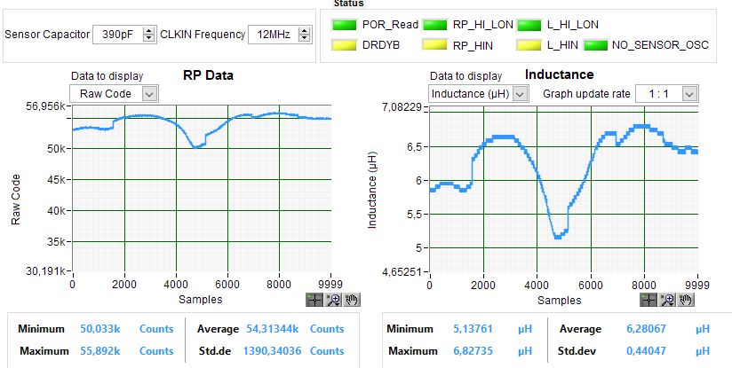

    I have in another post remarked that data stops or sampling go slower for some samples at the start of the block.
    Response Time = 192, the rest is as startup.
    Moving some metal by hand 1 -10 mm in front of coil. Look around  sample 1500 and sample 5000.
