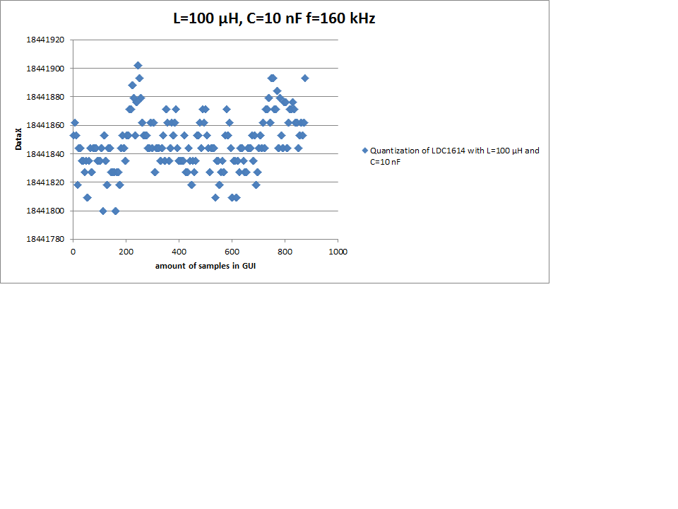

  •   Hi Chris, thanks a lot for your answer.
    Unfortunately, I think I have a specific question in detail:
    For example I use 20 MHz as fref and sensor frequency of 1,6 MHz. In EVM GUI I set sample time to 1 ms (register 0x08).
    In sample time of 1 ms the LDC 1614 should count: fref=20000 and fsens=1600 counts.
    In relation to your example with an ADC converter I get:
    count fsens/ count fref = 1600/20000 = 0,08
    This ratio is mapped by multiplication of 2^28 to value of DATAXCH0=21474836,48
    But if fsensor is changing only full periods are counted: so instead of 1600 counts now 1601. I assume that fref count is stable so we get
    a new ratio: 1601/20000=0,08005 mapped to DATACH0= 21488258,2528
    This seems to be a huge step between two different counting data.
    Does the LDC1614 contain any part of PLL to multiply reference frequency?
    In my measurements I got much better resolution with gap of only 10 in DATACH0(see attached figure)
    This means, that either in LDC1614 core a higher frequency is used to get this
    resolution or another principle of frequency count of fsensor and fref is used.
    Until now I thought that only every amplitude level of i.e. 0 V is sampled and count.
    Can you give me more detailed explanation of this procedure? It isn't written
    in datasheet. There I only found the formula. I would like to know what is inside
    the core and how does it count fsens and fref.
    Tim Gerbert

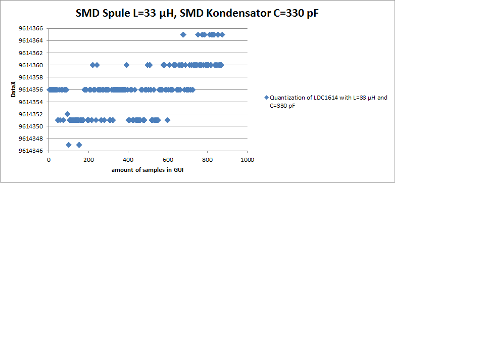

    Furthermore I have a question about the quantization to a digital signal.
    I measured with different sample coils a noticed that the resolution (gap between to counting values) is different to sensor tanks and also frequency (see attached figures).
    Tim Gerbert
    With different coils, but same reference frequency I should only see difference in counts for fsens. So the quantization should be equal all time. Unfortunately I can´t see this in my attached figures. Why?

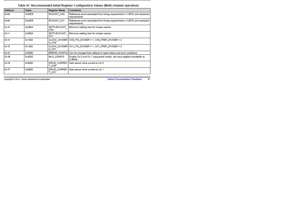

  • hi my name is Matteo,
    I'm using a LDC1614 board with the LC sensor already attached on the board to measure oscillations of a mechanical structure.
    I ve already calibrate the sensor with a specific target that i fixed on the structure.
    The data are acceptable, but i ve problem regarding the sample rate.
    Even setting a sample rate of 1 ms, 1000 samples per second i get around 1/3 of samples is should have (1000).
    I set the Rcount and settlecount according to the formulas provided in the datasheet, i'm using the internal oscillator, divider code 1, Fref 43,4 MHz.
    Another question is about the sampling time, if i sum the sampleDeltaMs i should get the total time of acquisition? And if sampling rate is constant why is the DeltaMs different for every step of data recorded?
