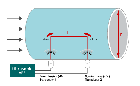

  • I want to use tdc1000 to calculate the gas flow inside the pipe. The model of the device is like this.
    D is about 2.5cm, and in the later application may increase to more than ten centimeters. L is about 6.5cm.
    Now i have a tdc1000-tdc7200 evm, but i don't kown hao to set the parameters of each register. The frequency of  transducer is about 75khz , is it suitable to the experiment?
  • For gas flow the usual frequency is 200-300kHz. The distance is a minimum of 10-12 cm for water. For GAS you will need to increase the distance substantially as it can take up to 30 pulses to get the transducer generating enough sound energy to receive at the other transducer. There must be enough physical distance between the two transducers so that the entire echo envelope can be clearly detected. The greater the distance traveled in the medium the more sensitive the flow sensor.
