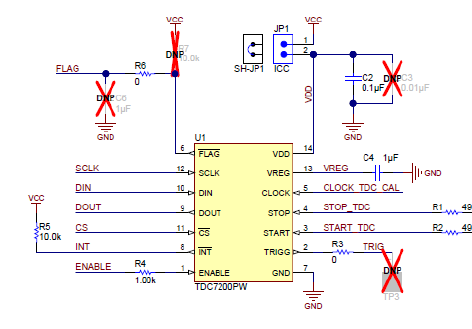

In the schematic of TDC7200EVM User’s Guide, pin 6 of TDC7200 is FLAG, but in the datasheet of TDC7200, pin 6 is NC.
So does pin 6 have a FLAG function or not? Thanks.

Eric,
Data Sheet is correct. No Flag function on pin 6.
