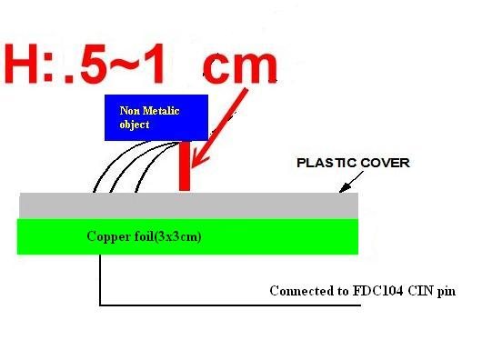

Hello everyone, I have been trying to detect non conductive objects using FDC1004EVM to test  the Capacitance-to-Digital Converter FDC1004 but but I haven't been able to detect a significant change in capacitance (My setup is as in figure.).
The copper foil are is 3x3cm.The plastic cover thickness is around 3mm. The cable length is around 5~10cm.
When I tried to detect an plastic object the change in capacitance is around 0.2pf. I unsure as to how stable this value will remain.
Can you help me to have a better stable difference. what changes should I do to get better results.

    The change in capacitance that you are seeing is reasonable. It's because the dielectric constant is very small, not too much difference between air. To get higher sensitivity, make sure the sampling rate is at 100S/s and you can probably have the gain setting at it's highest. The only issue with the gain setting is that it's post operation, in the sense that both the signal and noise will be amplified.
    Stability is dictated by system environment, and unfortunately, I cannot comment on this since I do not know where your system will be used in.

    Though 0.2pf may be reasonably good, the problem is that every time the base reference keeps changing. So I dont get how should I fix my reference value to enable detection. Like the base reference value changes with the movement of cable. That has been the challenge for quite some time. I tried different shelding techniques nothing seems to work.

  • The issue you are seeing is a mechanical/setup issue not an electrical issue so changes in schematic will not make a difference. It's very typical for system setups to experience capacitance drift. You need to compensate for this in software....
    Please refer to http://www.ti.com/lit/an/snoa939/snoa939.pdf
    It can help eliminate the drift you are seeing, but it is also dependent on the rate of change of the target itself relative to the noise/drift you are seeing.

    You were correct , I have been to work with it, the change in the capacitance value is consistence.
