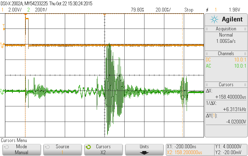

When I monitored the signal, there is strong first echo at 80 uS all right.
1480*(80*10^-6)*100/2 = 5.92 cm
But GUI measured the 160 uS --- the next echo, I think.
Is there any way to measure the 1st echo ?

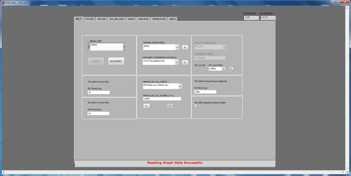

(1) Oscilloscope waveform
(2) Setup
(3) TDC1000 setting
(4) graph
(5) tank level

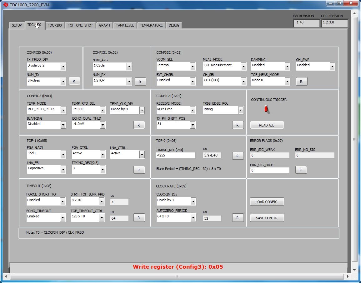

  • Koyo,
    A few questions first:
    1. what frequency is your transducer?
    2. What are your measuring requirements (min/max height)?
    3. Can you send a scope picture that includes your Stop signal as well?
    I believe the big issue is your Autozero time and your blanking.
    Set your Clock Rate reg to 0x00 will reduce the "autozero blanking" to ~32us so it will detect the first echo.
    Also increase your Vthrshold to 410mv.

    I'm attaching a register file that can be loaded to set all these values.
  • Dear Matthew Minasi, thank you very much for the configuration file "TDC1000_Kobe_Setup.txt"
    I loaded your configuration file and tried again.
    I added my answer to your question below.
    1. what frequency is your transducer?   1MHz
    2. What are your measuring requirements (min/max height)?    min : 20mm   max : 2000mm

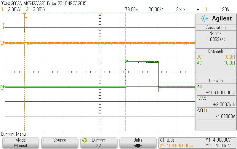

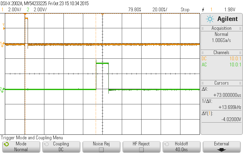

    3. Can you send a scope picture that includes your Stop signal as well?   I get the picture with your configuration file below.
    1) START and COMPIN_OUT
    2) START and STOP
    Also increase your Vthrshold to 410mv.TDC1000_Kobe_Setup.txt

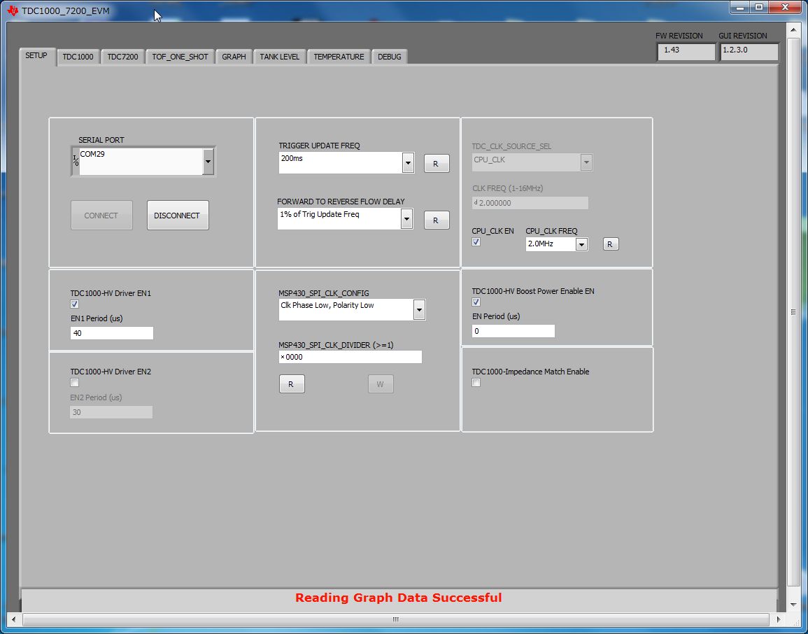

  • I tried the same experiment with TDC1000-TDC7200EVM today as the reference.
    Default setting is fine and I can measure the first echo all right.
    With the 8MHz clock, TDC1000 works all right.
    So, there seems to be some limitation when I use the 2MHz CPU clock on TDC1000GASEVM, I think.
    (1) START - COMPIN_OUT
    (2) START - STOP

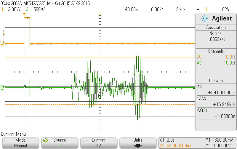

  • LDC1000-GASEVM's limitation seems to be much longer than 32uS, I feel.
    By the way, I tried one more test.
    Connecting the high voltage drive board of LDC1000-GASEVM (TDC1000-BSTEVM) to the LDC1000-LDC7200EVM.
    ( Mixture of two EVMs ---  LDC1000-LDC7200EVM's 8MHz clock and LDC1000-GasEVM's 30V drive board)
    I think there is no problem with this combination.

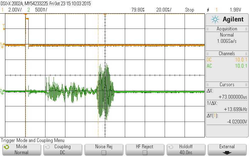

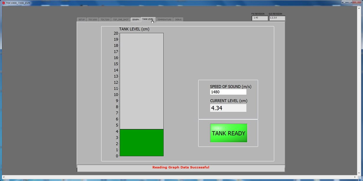

    I can measure 59uS echo = 4.366 cm water level in the tank with them!
    This time, the second echo at 59uS is the real one.
    The first echo at 35uS seems to be from the polycarbonate case.

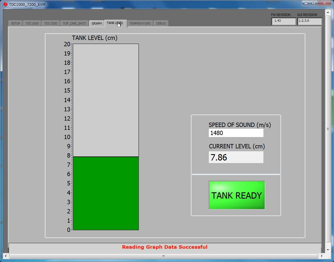

    (photo)
    (scope)
    (graph)
    (tank)

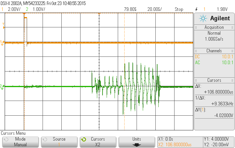

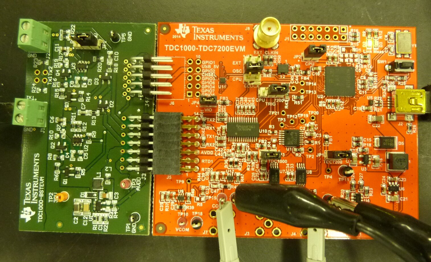

  • I checked the waveform at J1 pin-1 = Ultrasonic Transducer voltage.
    The voltage is much lower than expected.
    It is not 30Vp-p, only 1 Vp-p.
    I compared the TDC1000-GASEVM and TDC1000-BSTEVM Kit User’s Guide 15 TDC1000-BSTEVM schematic Figure 27 with the real board.
    There are some differences.
    R5 = 51.1k is not there. Nothing was soldered.
    So, TP2 is not 30V. TP2 is only 3.6V.
    R10 is not connected.
    So, Vdd1 is not 30V.
    Maybe the Ultrasonic Transducer is actuated from Rx2 ( which is connected to Tx1 ) through R13=300 and C7=300pF.
    That's why the received signal is so weak.
    I'll add these missing parts tomorrow to drive the ultrasonic transducer at 30Vp-p.

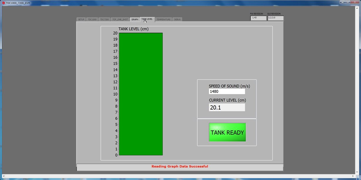

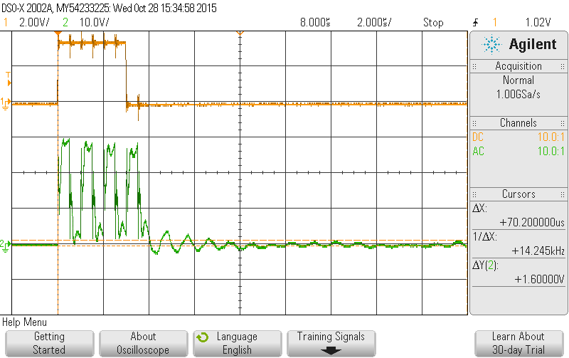

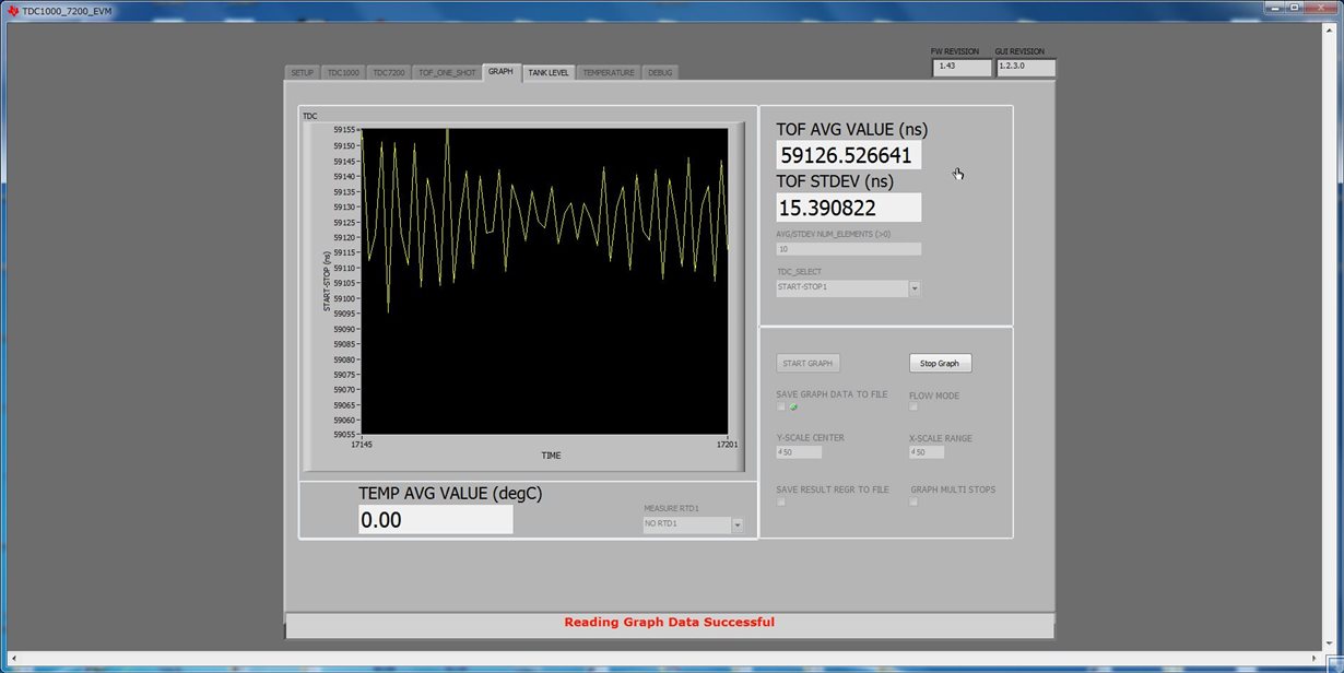

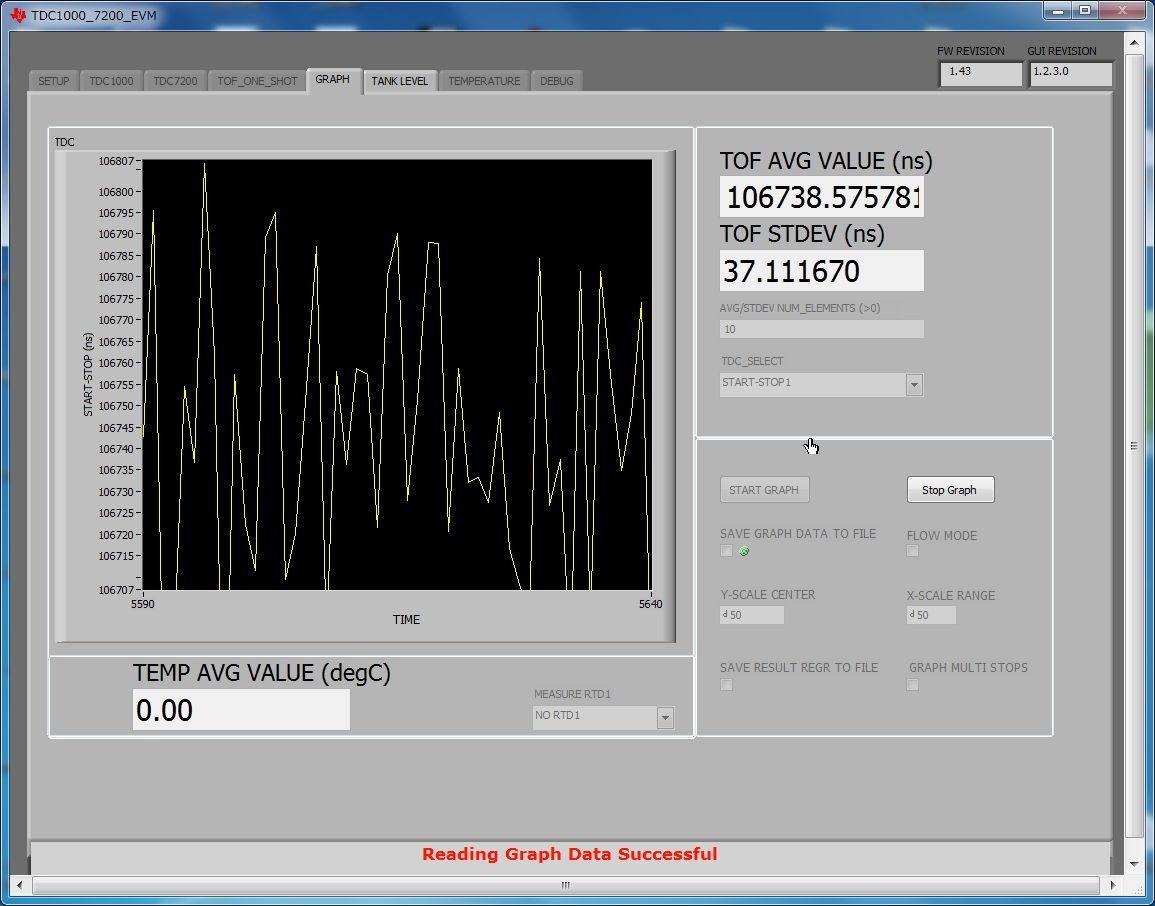

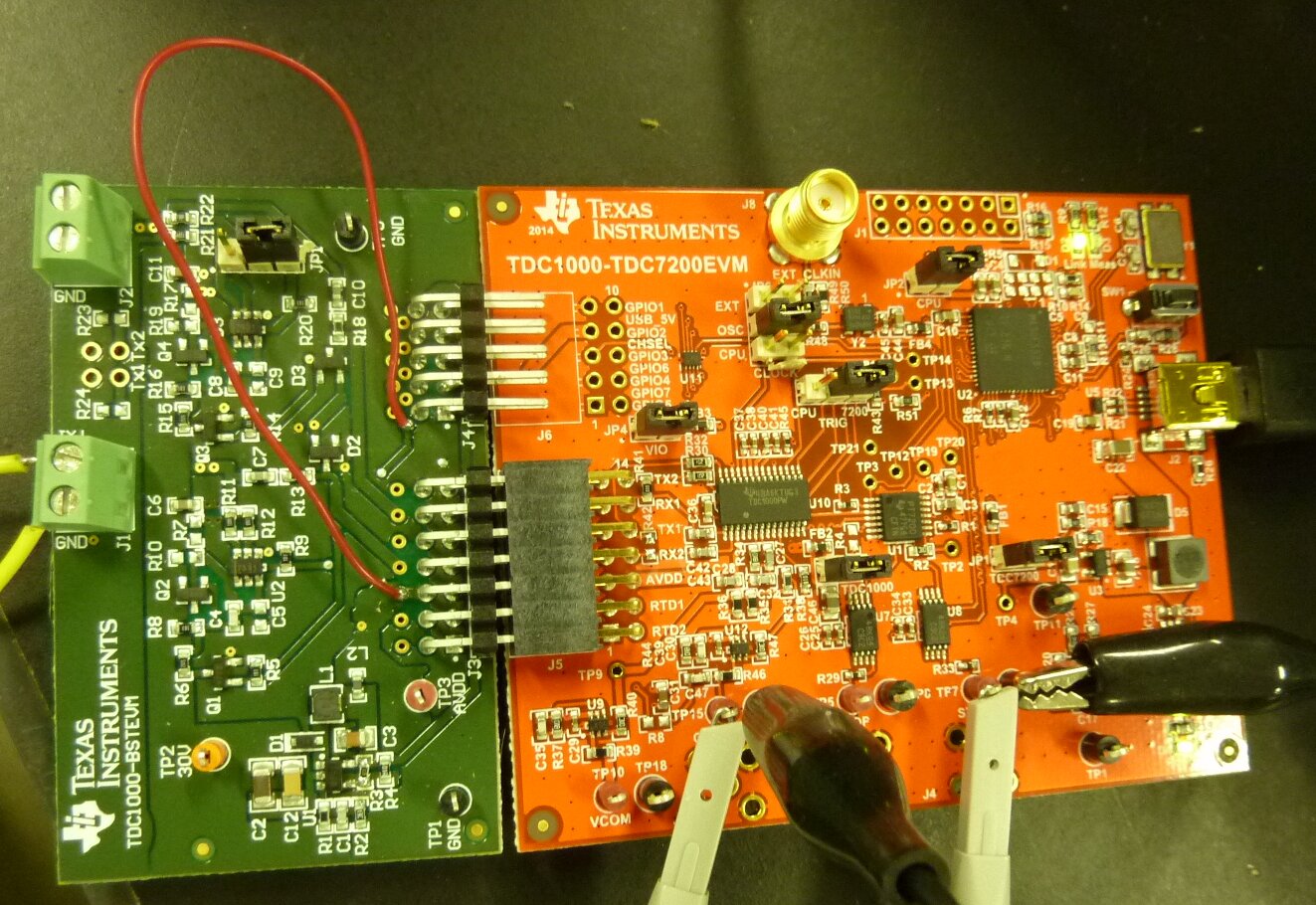

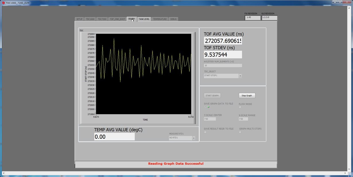

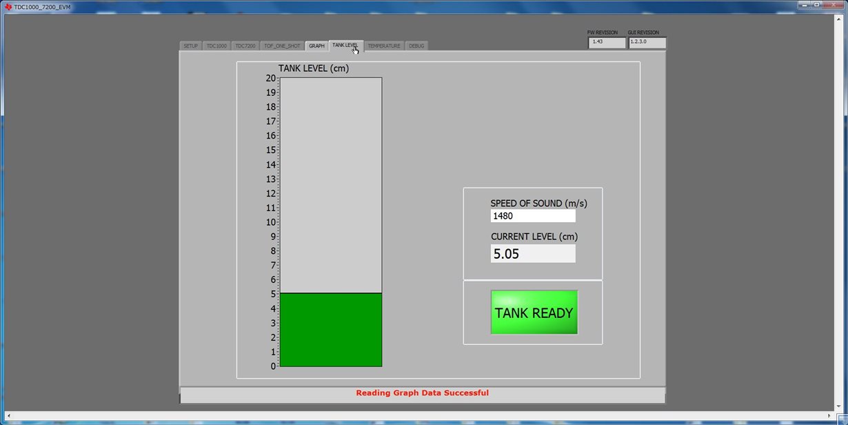

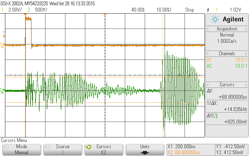

  • I modified TDC1000-TDC7200EVM board --- removing R42=0 ohm.
    I also modified TDC1000GasEVM's BSTEVM board --- R3=12k ohm (not used), add Jumper wire between J4-1 and TP3=AVDD.
    Now, I can transmit 1MHz 30Vp-p signal all right.
    (photo)
    (scope Tx signal 1MHz 30Vp-p)

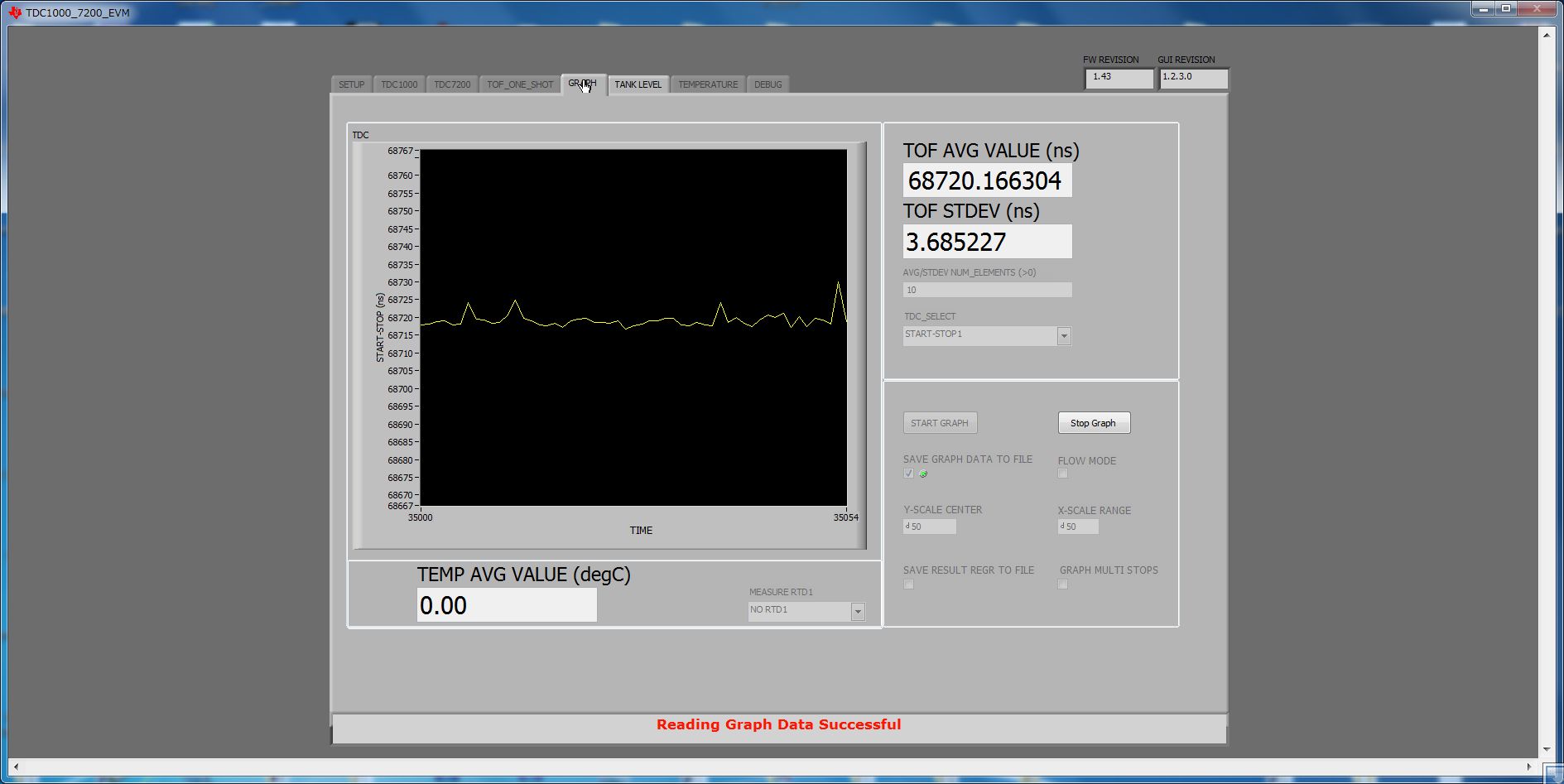

    (scope : start and comp-in 68.7uS)
    (graph 68.7uS)
    (tank 5cm)

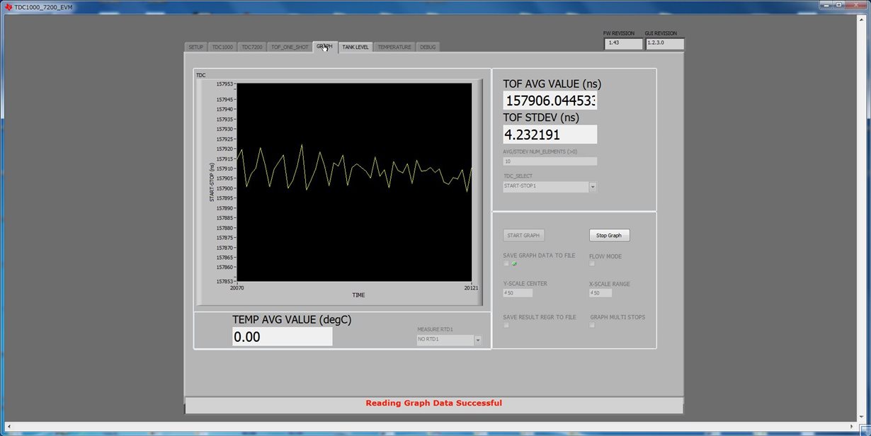

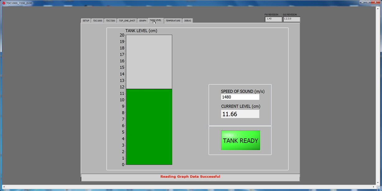

    ( after adding some more water up to 20cm )
    (graph)
    Now, I need to write some software to try the water level up to 100cm and 200cm in near future.
  • Koyo,
    The TDC1000-7200 EVM isn't shipped to interface with the BSTEVM without making modifications  to it first.
    As you discovered  R41 and R42 will need to removed. Also C42 and C43 need to be removed and replaced with 0 ohm resistors to make the TDC1000-7200 EVM work properly the the BSTEVM.
    Jumping J4-1 to VDD will reduce your echo size and isn't necessary as this is controlled by firmware driven on the MSP430. You will need to the the Boost Supply set the HVEN duration however as described in TDC1000-BSTEVM User's Guide. I'm attaching a version for you're convenience.
    SNIU026_updated_sch.pdf
  • Thank you very much!
    I checked the SNIU026_updated_sch.pdf you sent me.
    The reason why I put the Jumper (J4-1 to Vdd) is that there is no J6 on the TDC1000-TDC7200EVM.
    (please check the photo below)
    I don't have the 10-pin female type angle connector which is needed as J6 on the TDC1000-TDC7200EVM to connect to J4 on the BSTEVM.
    It'll take somedays to buy it from Digi-key as I need to import it to Japan.
    So, there is no connection between J4 (BSTEVM) to J6 (TDC1000-TDC7200EVM) now.
    So, I put the Jumper wire instead now.
    Anyway, I think I have enough information to go on the design.
    Thank you very much again for your help!
  • Koyo,
    Your welcome.
    If you are ok with jumper wires you'll want to jumper the VDD1_EN connection (J4-p1) to JP4-p1 instead of to VDD. It will give your receive circuit 3-4 times more sensitivity. This signal controls the power to the UCC27531 and disables it during the "receive" time. If it is always enabled it loads the transducer with 110 ohm to GND which attenuates the receive echo. I notice you installed R3 on the BSTEVM which is the right choice.
