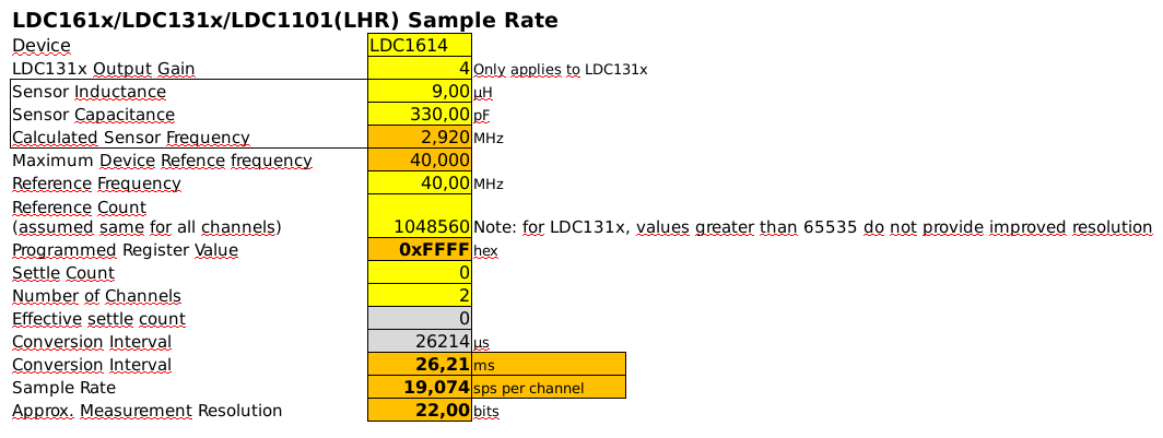

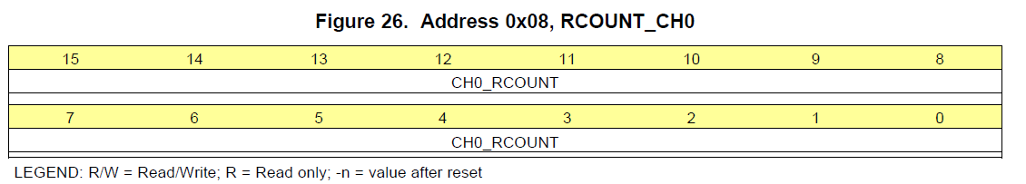

I got a question about conversion time with LDC1614 in multichannel mode. The register "CHx_RCOUNT" determines ENOB of bits and resolution. In datasheet the LDC1614 should be able to sample with 28 bit resolution. So if I want to have this ENOB of bits, I want to write 2^28 = 268435456 =0xFFFFFFF into register "CHx_RCOUNT".
But this register is only a 16 bit register. Is it right that then I can only get ENOB of 16?
