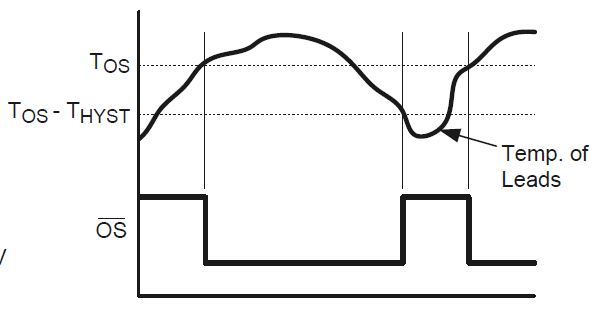

Hello, We are using part# LM26CIM5-NPA to control a cooling fan inside an outdoor TV enclosure. According to the spec the device triggers at 45C. What temperature should the device reset itself ? Thank You

Hi Larry,
The LM26 device never resets itself. But if you are talking about resetting the OS/!OS/US/!US pin after it has triggered at 45C then you have to look at the hysteresis value. The LM26 comes with an option of 2C or 10C hysteresis programmable via a pin. The output pin will stay active until it reaches the value of Ttrip - Hysteresis. A graph of it is seen here for a LM26CIM5-TPA:
