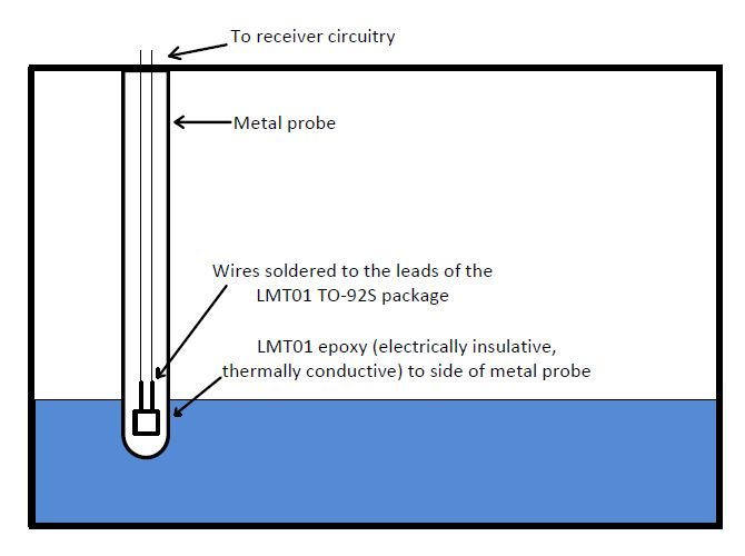

I am looking for the lowest cost temperature sensor to accurately measure the temperature of water running through a faucet. Any suggestions?

Here is an image I made before for a previous E2E post:
The drawing uses a LMT01 temp sensor, which is a 2-pin temperature sensor that has 0.5C accuracy at room temperature and 0.7C across the full temp range of -50C to 150C, mounted inside a hollow metal probe. The drawing uses a water tank but it can easily be changed for a pipe in a faucet. Hope this helps!
