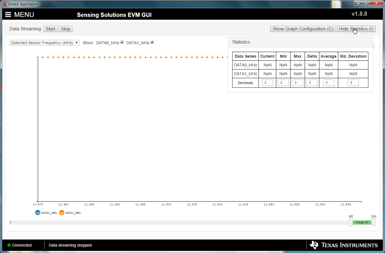

I downloaded Sensing Solutions EVM GUI Tool v1.8.8 today from the link below.
http://www.ti.com/product/LDC1614/toolssoftware
I installed it, and start Sensing Solution EVM GUI.
I connected LDC1614EVM and select Data Streaming all right.
But the displayed data is always at the top.  Saturated NON value.
When I chose the Raw Code, it looks all right.
But, When I chose Inductance, the data is always at the top.
When I chose Detected Sensor Frequency, the data is always at the top.
What should I do?

  • Kegasa-san,
    Please set Fin to the value of 1. (And also any other parameters which are marked in red, has to be set to an appropriate value)
  • Hello Kegasa-san,
    To clarify Evgeny-san's recommendation: the Fin Select column on the Sensor Properties table should be set to 1 for all channels.
    Chris O
  • Thank you very much.
    I set all the divide ratio and all the Fin select from 0 to 1.
    So, the value displayed in red in the configuration page means - something is wrong!
    Now, I can get the frequency and the inductance all right.
    The data in log file data.csv is also all right.
    Thank you very much again for your help!
