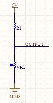

I have a simple sensor that I'd like to connect to the PGA900 and get a 4-20mA output.  The image below shows the a schematic of the sensor.
I'm a little confused on what pins I should be connecting this sensor to.  I have the PGA900 setup as described on page 119 of SLDS209A.
Any help or guidance would be greatly appreciated.
Thank you,
  • Hi Kevin, the PGA900 pressure input pins are differential (VINPP and VINPN). Based on your schematic, I am assuming this is only one of the legs of the sensor (VINPP for example) and the second leg (VINPN) would be connected to a fixed voltage. The PGA900EVM offers something similar to this setup where VINPN is connected to a fixed voltage of about 1.25V (assuming VBRGP=2.5V) and VINPP is changed by having a digital potentiometer in that leg. Please refer to the EVM schematics in p.16 of the EVM user's guide, the document number is SLDU011.
    In addition, please notice the pressure input common mode constraints for the PGA900 shown in p. 11 of the datasheet. As you can see, the single-ended voltage for either VINPP and VINPN should be between 0.3 and 1.8V. Therefore, using a 5V supply for your sensor will probably not satisfy this. Usually, the sensors are excited by the device itself (PGA900) using VBRGP and VBRGN. If you configure VBRGP to 2.5V and following my recommendations above for the legs of the sensor, then you should be good satisfying the common-mode range constraints.

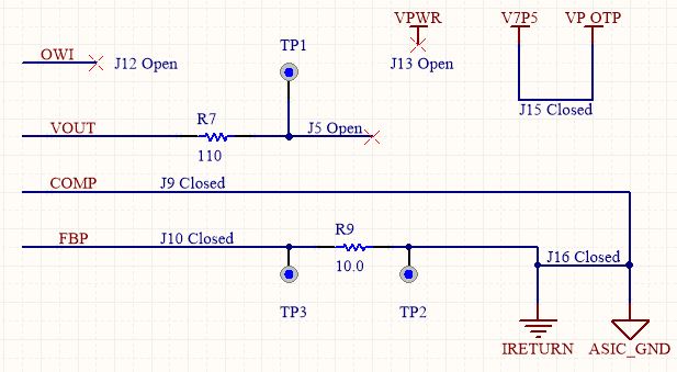

    I'm not getting the response I'm expecting from the PGA900 and I know it has to do with jumper settings.  I created a schematic (below) showing the jumper setting configuration called out by "DAC OUTPUT CONFIGURATIONS" in SLDU011 p.16.  Also, J1 shows (pins 1-2)?
    R9 reads 9.78ohm on my bench top DMM.
    For now I think I'd be happy having the PGA900EVM running a testable current loop controlled through DAC_REG0. But I'm not there yet. Can you provide a table or image of the EVM with the jumper setup for a 4-20mA loop test?
  • Kevin, as you suspected, your jumper settings are not correct. For 4-20mA operation, the output stage must be configured the following way:
    1. Close J4, J5, J9 and J10.
    2. Open J6, J7 and J8.
    Unless you are programming the OTP in the device, J15 should be open. J15 should be closed ONLY when you are programming OTP. In addition:
    1. J16 must be open for 4-20mA operation.
    2. J19 must be set depending on whether you are using I2C/SPI or OWI. However, since this device will not have firmware based on what you have mentioned, then it will have to be I2C or SPI so set J19 to pins 1-2.
    3. J14 should be set to pins 1-2.
    3. Open J11 and J12 and close J13 (same voltage applied to the EVM will be the voltage applied to PGA900).
    4. Assuming you use SPI, open J25, J27 and close J24, J26, J28 and J30.
    After this, you should be ready to set the registers to 4-20mA configuration using SPI.
    JV

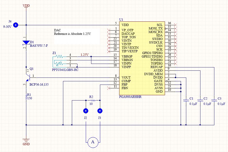

    I've been playing around with my sensor and trying to adjust the EVM so that I can use the sensor "Z1" as drawn in the schematic below. I have bypassed the external bridge by removing J1, J2 and J3 from the EVM.   VBRDG_CTRL is set for a 1.25V output which I plan to use as you can see below.  The sensor basically will divide the voltage which I expect to read on VINPP.
    My question is; should I be able to configure the EVM using the GUI to accomplish my 4-20mA output without having to write a custom program?  Please let me know if you need any more detail.
  • Hi Kevin, I am glad you got to work the 4-20mA loop operation. Regarding your test with your sensor, yes, you will need firmware in the PGA900 to relate the input to the PGA900 to the output of the PGA900. This is because the PGA900 is an open core device and, as a result, the analog front end needs to be linked to the analog output using digital firmware. This is shown in the figure below. However, you can use the reference firmware at ti.com as a starting point. The reference firmware is located at http://www.ti.com/lit/zip/sldc010
    In addition, looking at your schematic, there is a mistake regarding the FBP pin. FBP is the return path for the loop current back to the controller. In other words, the other end of R2 cannot be connected to GND of the PGA900. It should be the connection to the negative terminal of the controller. There is an app note that describes the operation of the PGA900 as a 4-20mA loop transmitter. Please take a look at Fig. 1 and you will see the issue with FBP that I am talking about.
    http://www.ti.com/lit/an/slda030/slda030.pdf
    Finally, you will need to be careful with the common-mode requirements for the PGAIN inputs and outputs. The single-ended voltage for the PGAIN input must be between 0.3V and 1.8V and the single-ended voltage for the PGAIN output must be between 0.1 and 2V which means you need to select a value for PGAIN to fit this requirement.
