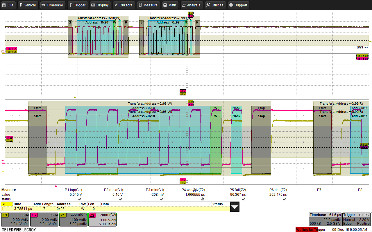

Most interesting: when using low PullUp values (2k2 / 4k7) it doesn't work. with 10k it's working sometimes, but with 22k and very long rise times it is working.
When checking with the oscilloscope I cannot see any problem with the I²C Protocol or any timing issues. The oscilloscope is decoding correctly everytime!
You can see that risetime is in specification with the TMP421 values...
Any help will be appreciated!

    Do you see a Timing or "Shape" issue from the scope screenshot above? In my opinion it looks like a good signal. But the TMP421 only acknowledges it, if I use 10-22k pullups and the rise time equals the high-duration of clock!
    Benjamin

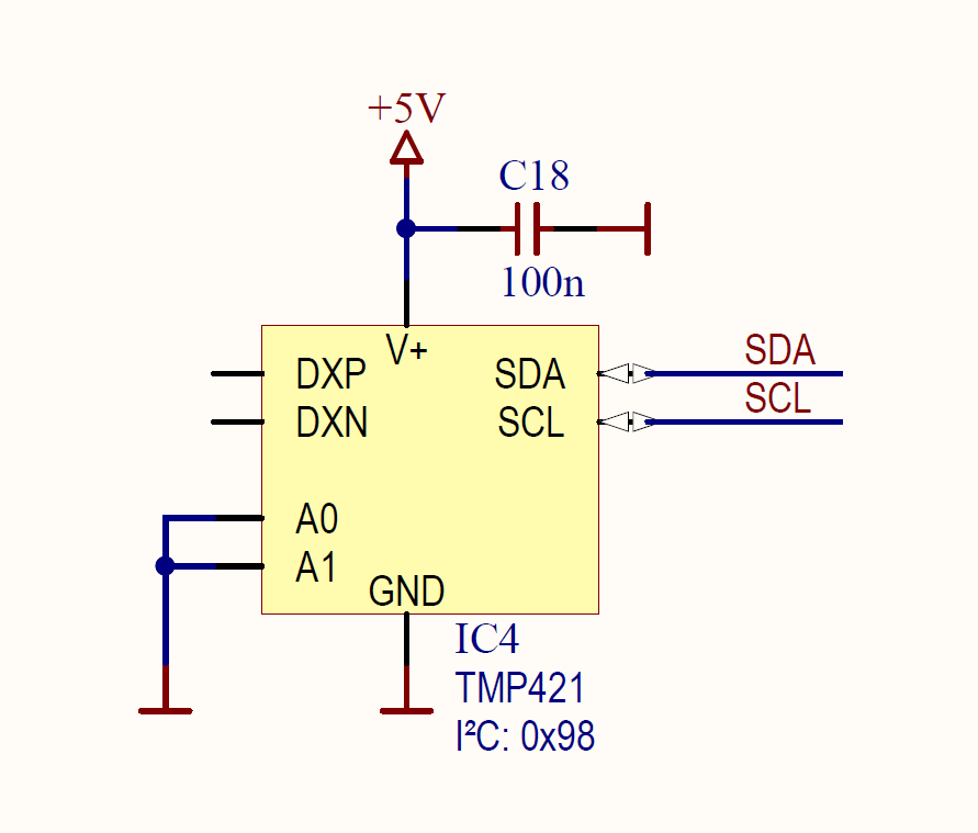

    1. What do you connect the A1 and A0 pins to (VDD, GND, or floating)?
    Aaron

    Both address lines are connected to GND.
    Benjamin

  • Hello Michael, Aaron,
    IMHO the TMP421 behaves not as specified by the datasheet.
    According to our oscilloscope, the fall time is about 95ns, but the sensor needs an additional SDA hold time to work.
    Datasheet states that ONLY below 20ns the hold time must be increased (otherwise Thddat=0ns) - but this seems to be also the case if the rise/fall time is about 10times slower.
    Nevertheless, solution was possible using a tweak in the AT32 TWI register CWGR setting the CWGR.DATA to a value higher than 4!
    Benjamin
