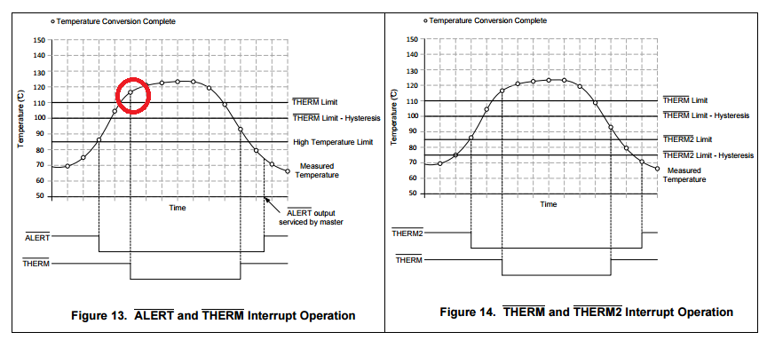

About TMP461:
in datasheet page 13.
In Figure 13,
1.Why /THERM change from high to low not at 110°C Temperature immediately.   And /THERM delay a little time from high to low not after 110°C Temperature?
2. What is THERM Limit - Hysteresis?
BRS
Nat
  • Hi Nat,
    Sorry for the confusion! The THERM pin trips when the measured temperature result is higher than the THERM limit register (0x19 or 0x20), and THERM pin untrips when the measured temperature result is below the difference of (THERM limit register -  THERM Hysteresis register). The THERM limit – hysteresis is the temperature setting for the THERM pin.
    For example, let’s say THERM limit register sets to 110°C, and the result temperature is 116°C then the THERM pin will trip. If hysteresis register is set to 10°C then the THERM pin will untrip when the temperature result goes below 100°C.
    You are absolutely correct that there is a small delay between each point of the measured temperature. Why the THERM pin didn’t trip at 110°C but instead of 116°C. The circles on the measured temperature line in the graphs indicate when the temperature conversion ends. Since the THERM and ALERT limits are compared with the temperature result at the end of the conversion and not simultaneously, the THERM and ALERT flags and pins will also trip and untrip at the end of the conversion. This is why you see a small delay.

  • Hi Nat,
    I wouldn't call that is a delay time. As I mentioned on the previous posted, the temperature comparison didn't happen until at the end of the ADC conversion time is completed. For example, the THERM hysteresis is set 110°C by the time the temperature register (0x00 or 0x01) is read, the temperature result is already reached to a higher temperature. That is why the graph indicated that the measured temperature at 116°C, and the THERM pin trip at that moment.
    The typical of conversion time for both local and remote is 15ms. Please refer to EC table if you need more detail.
    Hope this helps!
