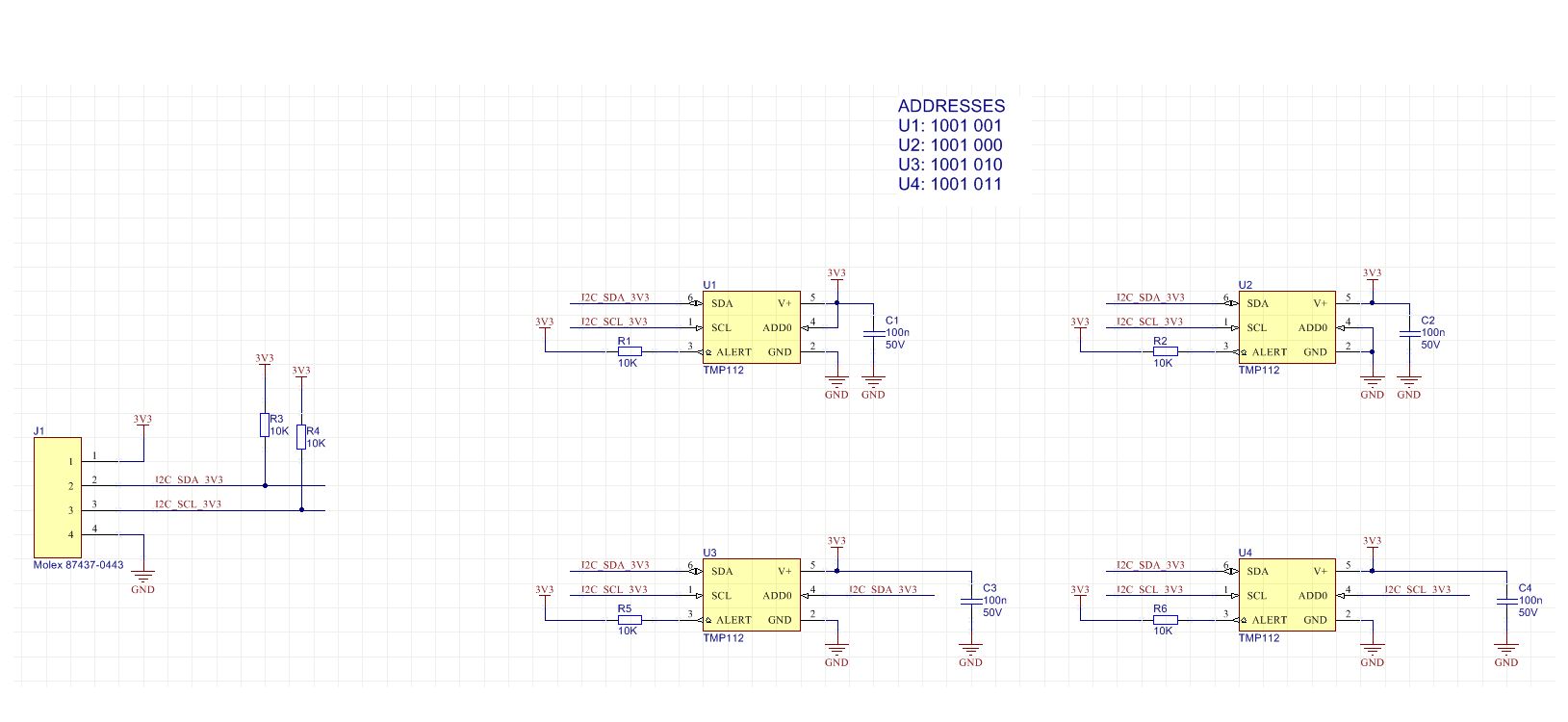

We have a board that essentially just has I2C communications coming into it, that are connected to 4x TMP112. The TMP112 has four possible available addresses, depending on what you connect the ADDR pin to, however it appears as though one of the addresses does not seem to work for us. When the ADDR pin is connected to the SDA line, the device should use I2C address 0x4A, however nothing appears on that address. We have hooked up a scope to verify that the correct waveforms do appear on the SDA and ADDR lines ruling out signal integrity issues.
This is happening across all of the boards we made, and we have tried assigning one of the other chips to this address instead but it still did not appear.

    The schematic is looking good except that the pull-up value might be a bit too high. We recommended a 5kΩ pull up resistor. Could you please provide a raw file of the scope photo when you tried to communicate to the 0x4A?

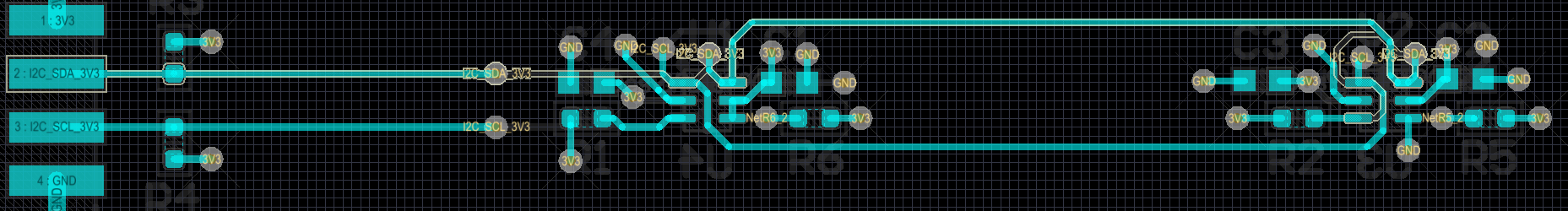

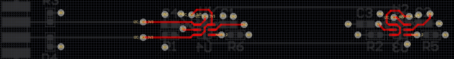

    I'm the client of Chee Boon who asked this question, figured it will probably be easier for me to respond directly from here! I have taken some DSO images of the communications lines as seen below. It all looks pretty clean (some overshoot and very minor coupling, but seemingly no delay between SCL / SDA), and the routing is fairly straight forward and short (signal trace lengths ~40mm). I have attached screenshots of the routing also (connector on the left goes to any external I2C host, in the case of the screenshots below it was connected to an Arduino, although it is typically connected to an FPGA).
    In relation to the higher value pullups, we have also attempted to drive this board from another system which has 1k pullups on that line as well, and suffered the same issues, although we may replace the 10k with 5k on one board to test, just to cover all bases.
    In the first image, the read from address 0x4A can be seen to be NACK on the left, while the read from address ox4B on the right is successful.
    Top layer routing -
    Bottom layer routing -
    The device which is not responding is the one on the right on the bottom layer.
