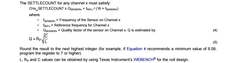

I'm following 8.2.2 Detailed Design Procedure instruction of LDC1614 Datasheet.
Example coil preperence is
Rp = 6.6 kΩ, L = 43.9 µH, C = 100 pF.
In the senction 2, There is mention about Q.
(a) CH0_SETTLECOUNT ≥ Q × f REF0 / (16 × f SENSOR0 )
SO I try to determine Q.
But, How to determine Rp for my custom coil?
WEBBENCH can design only for PCB Coil. But I wanna design for solenoid.
How to calculate Rp by L,C?
Have a good day.

    It looks like you want to set the SETTLECOUNT but do not know your Q or Rp. There is an easy way to get around that. You can determine the appropriate setting to use for the SETTLECOUNT registers using an oscilloscope - first make sure SENSOR_ACTIVATE_SEL is set to Low Power Activation mode. Then set the channel SETTLECOUNT to a high value (such as 0x8000). Setup the other register settings as appropriate, and put the device into active mode.
    Probe INAx to ground, and capture the turn-on signal. Measure the amount of time it takes for the sensor amplitude to stabilize to within 1% of its final amplitude. Then:
    SETTLECOUNT = fref * measured_time / 16
