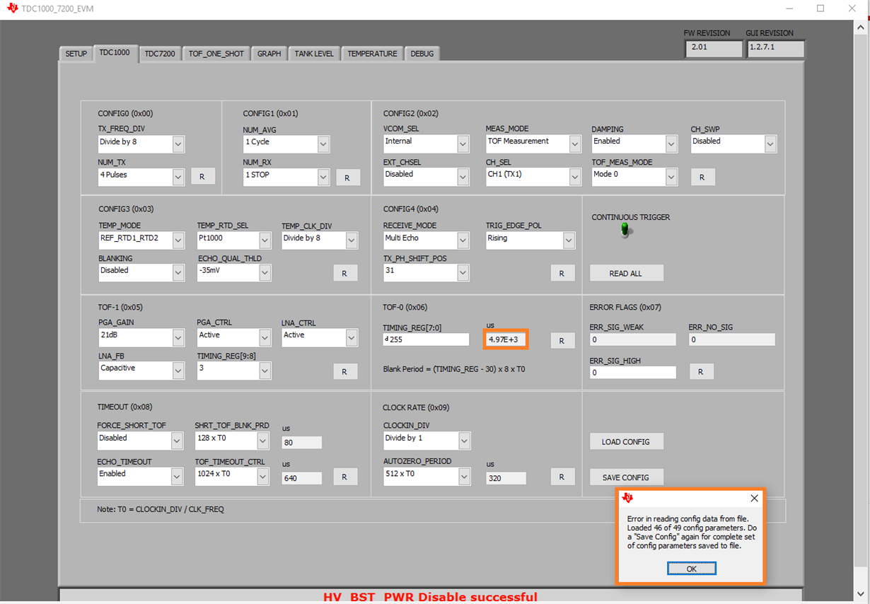

The module and GUI work fine. I do have one issue though:
When I generate a new Register file in Webench
webench.ti.com/.../index.html
I used Max fluid level 0.5 m, min fluid level 0.01m, Accuracy 3mm, Automotive Q -grade needed false, speed of sound 1480 (water), sensor SMD15T21R111WL.
I get errors when importing in the GUI's TDC1000 tab (firmware   2.01, GUI Revision 1.2.7.1). The kit doesn't sample after I've loaded that registry file in registry.
I've attached a zip with the downloaded registry file and the export of the settings after loading that file (as advised by the error dialog)
registerfiles.zip

  • We will have our SW check this condition, but the error condition occurs when a config file has been saved/created with one version of the GUI and then loaded with an upgraded version. If you save the loaded config file after the error message and then reload it again, the error condition will not occur unless you upgrade the GUI again.
  • Hi Bahram , this case is different.
    I'm using a file generated by the online TI webench tool, not from an older gui version:
    The Webench tool says that the file is specific for the evaluation board that I have, but when you load the file to the board it doesn't sample the liquid height.
  • Jan,
    There are two issues here:
    a) GUI error message you see when you try to load the web bench generated file:

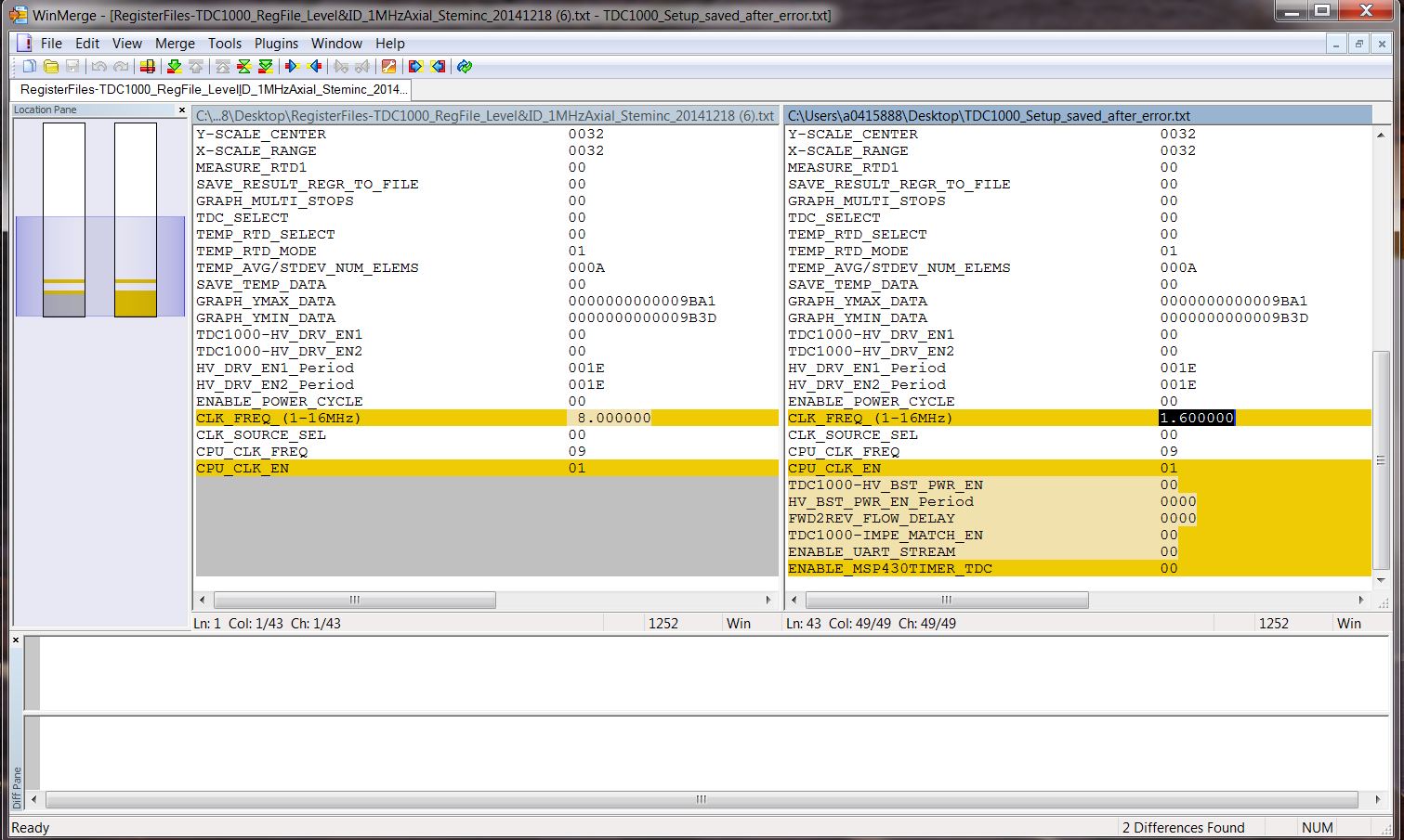

    I diffed the two files you sent. The GUI correctly loaded the web bench generated TDC1000 and TDC7200 register settings but for some reason the CLK FREQ setting changed to 1.6  when you saved.  Please check this when you debug your setup. Otherwise the two files are the same except for some additional parameters the GUI was missing (& gave error) when you tried loading. These parameters doesn't modify/apply to your use case.

  • Thanks for the answer, Vishy Viswanathan (1880315) .
    I figured out point a. I also have no explanation on why the frequency changed , but came to the same conclusion.
    It's easy to replicate:
    - install latest GUI for the evaluation board.
    - generate a file with the Webench config tool.
    You'll get the same error (that can be ignored)
    You'll also get that change in frequency when you save the file again. It seems to be the GUI that saves a different value than the one it received from the Webench app.

  • Jan,
    I took a closer look at the web bench generated file: it sets CLK_SOURCE_SEL as 0 which means on board osc (8MHz) and then also sets CPU_CLK_EN as 1.  This is the cause of the issue you describe above: CPU_CLK_EN can be set only if CLK_SOURCE_SEL is CPU_CLK.
    I fixed this issue and enclosed here two files:
    a)  RegisterFiles-TDC1000_RegFile_Level&ID_1MHzAxial_Steminc_20141218-Modified.txt : This is the modified web bench file CPU_CLK_EN set as 0
    b) TDC1000_Setup_new_saved_after_error: This is the new file saved by GUI after error
    This should help with the GUI error issue but I don't know if this resolves your other problem. Please let us know.

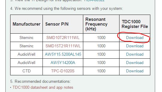

  • Jan,
    Thanks for looking at this. I'm working on updating the Webench application data files to create the correct files to match the latest FW/GUI and to work with an updated transducer list. Not sure how long this will take but once its complete we'll keep you posted.
    In the meantime for a file that is setup for level measurements with the 15mm transducer download the TDC1000 file under the Steminc SMD10T2R111WL.
    regards,
  • , the file downloaded via the SMD10T2R111WL link works!
    Thank you.
  • Glad we got you up and running and sorry for the hiccups.-regards,
  • Hi
    We tried with SMD10T2R111WL register files but still getting error which is different from initial one as
  • Config file saves, in addition to TDC1000 and TDC7200 registers, all the GUI settings as well. If the config file is old, it may miss a few of the new GUI settings. After loading the config file, you just do a "Save Config" from TDC1000 registers tab and save it to a new file. Save config will save all your settings plus any additional settings added for the new GUi. Config files are text files so you can open and compare the two files and see what's new. See a screen capture of the difference below.
    "Enable MSP430 Timer TDC" allows you to choose MSP430 timer to measure Time of Flight instead of TDC7200. This is useful for some level applications that don't need the TDC7200 accuracy. Please don't select this option if you are using flow.
    Similarly I suggest you don't select TDC1000 Impedance Match Enable and TDC1000 HV Boost Power Enable options. The "HV Boost Power Enable" is for Gas Flow applications that require high voltage boost power. We have a separate gas evm board for that.
