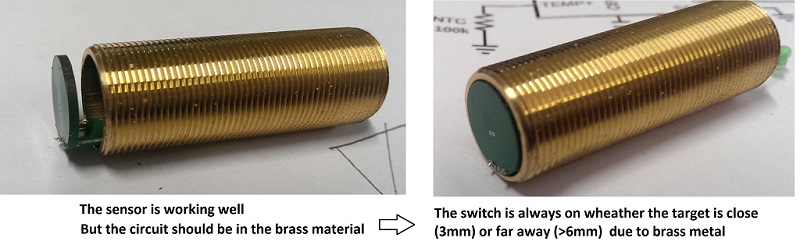

I have a some problem about coil designer:
We have to mounted this sensor into  the brass metal, but when I put it into brass material the switch is always on (Look at the picture please)

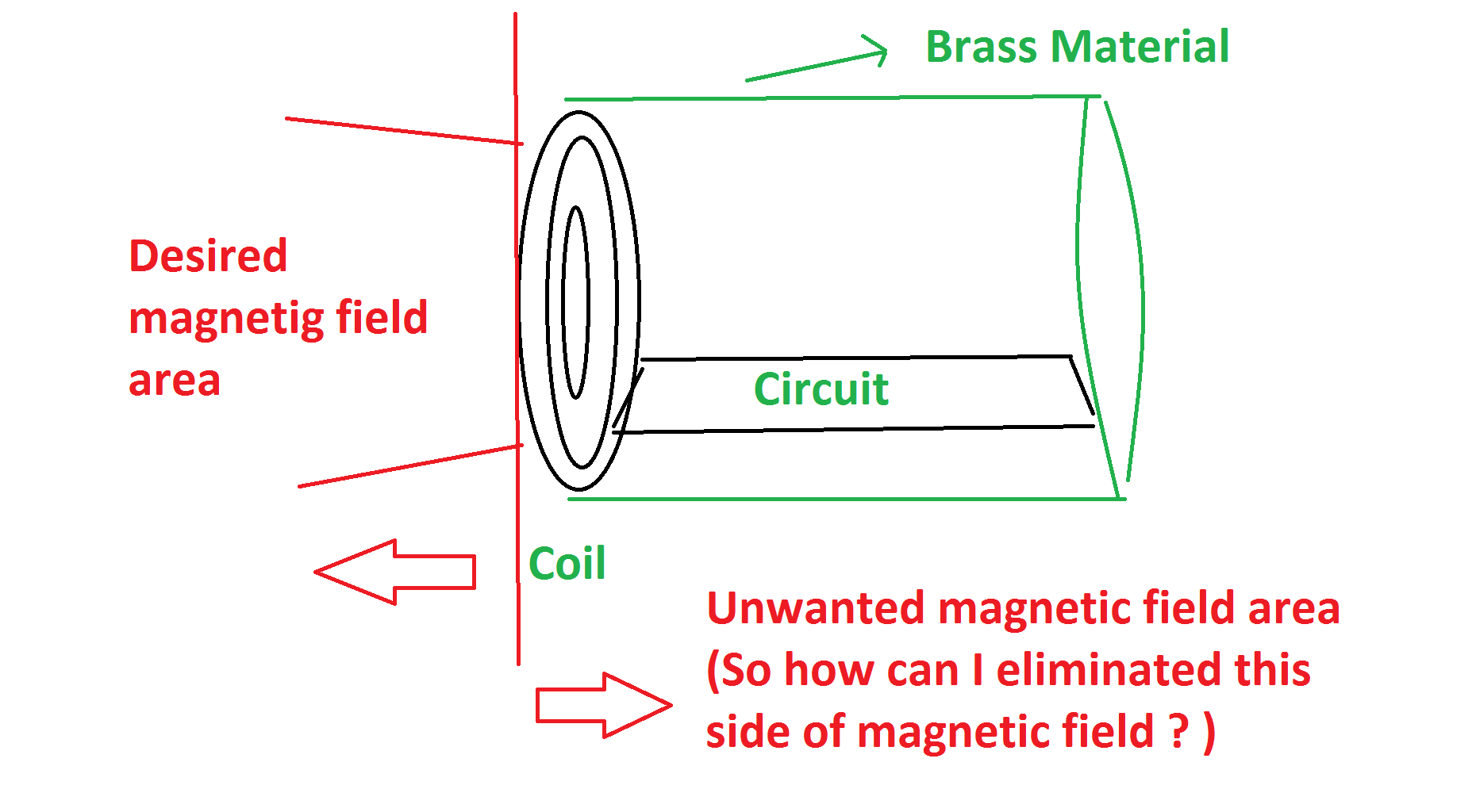

Q1: How can I eliminated magnetic field back side of the coil, side of circuit
Q2: I have used 4 layer series coil. Top layer, Inner Layer2, Inner Layer3 and bottom.
Is that better to use detect target with top and inner layer2?
And is that better using inner layer3 and bottom layer connected to ground for eliminated magnetic field?
Please give me some advise this issue?
