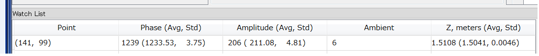

Q4) "Z" data of watch list
The data "watch list" display is "point cloud" data, right?
Or depth map data??
Because I have a Z data as 1.5108 m on watch list although the actual distance is 0.65m.
I do not understand why the distance is 1.5m.
I used "Short Range" profile then.

    A4) Z data of watch list
    The Z data in the watch list is the Z from the point cloud. It is not from the depth map.
    Your 1.5m (measured) vs 0.65m (actual) difference is probably because the profile was an uncalibrated profile. You can set one of the 'Metrilus * (HW)' profiles to check. (i.e., use 'Metrilus Short Range (HW)' instead of just 'Short Range')
