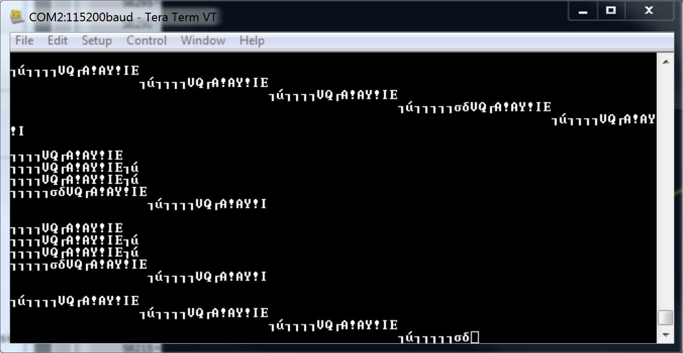

  • Hi Vishy,
    I am having trouble getting getting correct data out of the UART of my TDC1000-TDC7200EVM. I am getting  solid readings in the GUI. I have connected the GPIO pins 3 and 4 to my serial-to-USB port and I am using TeraTerm with 115200 baud. I just get garbage characters. Out of curiosity I hooked up my Saleae digital analyzer for serial async protocol to the GPIO pin 4. It does capture correctly though it reports an auto baud detection rate of 115900. I have tried everything I can think of including different USB-toSerial devices. Any thoughts?
    Bob
  • Bob,
    The UART baud is based on the MSP430 system clock (24MHz crystal on the TDC1000_7200EVM). Is anything changed on the board?
    You mention GPIO pin 4. In the schematic, it looks like pin 4 is MSP430 UART RX. You should look at GPIO3?
    Another question: In the Debug Tab there's a "Enable UART Stream" option. Did you enable it?
    Vishy

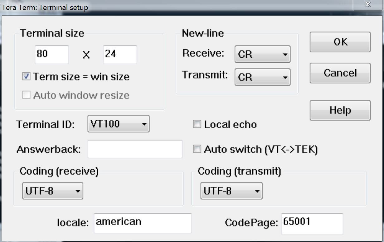

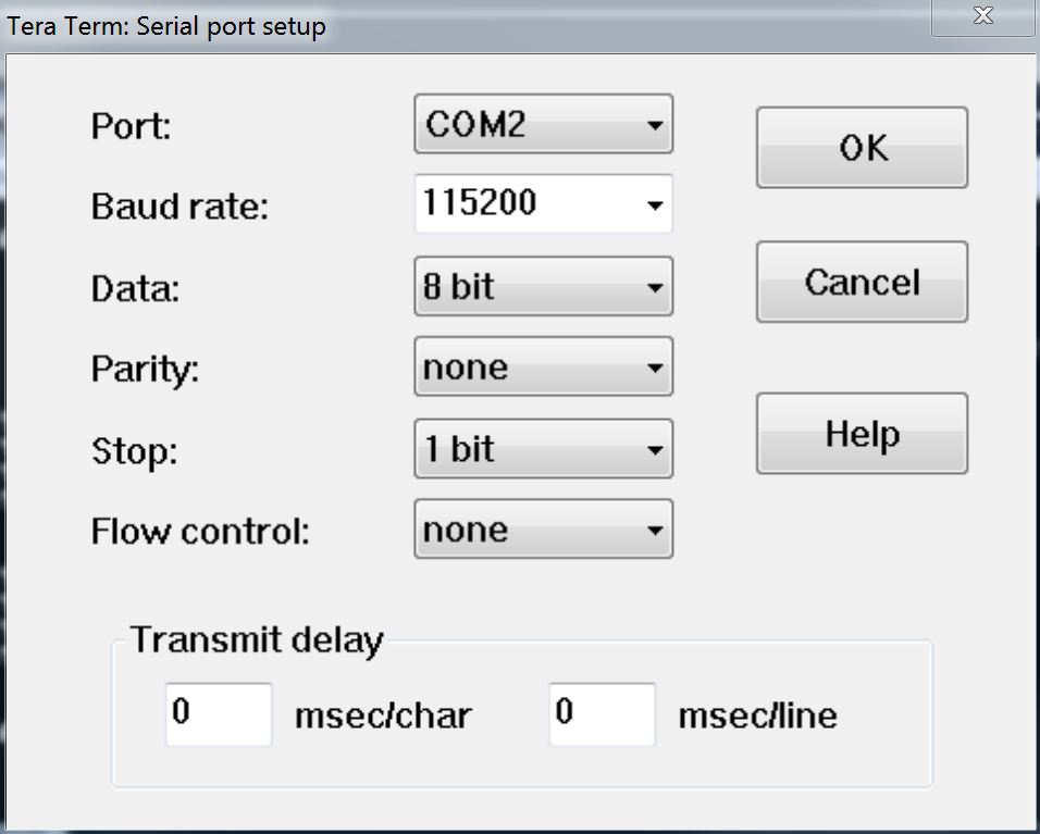

  • Vishy,
    Nothing is changed on the board. I should have said my Saleae analyzer was connected to GPIO3 which is pin 6. It totally gives the correct data stream, no problems. Yes, the stream was enabled on the Debug page. The problem is with the serial-to-USB that is connected to TeraTerm. That gives me garbage, I will paste my settings dialogs for TeraTerm again. It appears you can't just cut and paste images.
    Bob
  • Bob,
    I use the FTDI cable TTL-232R-3V3.
    Vishy
