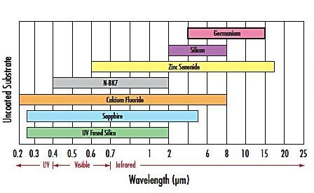

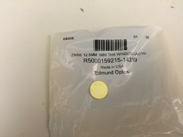

Hello Team,
Regarding the following thread, there are examples of cover or window material.
https://e2e.ti.com/support/sensor/temperature_sensors/f/243/t/117229
Do you have any certain window material of the followings which has been tested at TI or have proven design ? If so, it would be appreciated if you could tell us the manufacturer and the part number.
- CLEAR TALLIUM BROMOLODIDE KRS-6
- CESIUM IODIDE Csl
- SODIUM CHLORIDE NaCl
- POTASSIUM BROMIDE KBr
- POTASSIUM CHLORIDE KCl
- CESIUM BROMIDE CsBr
- CALCIUM FLORIDE CaF2
- BARIUM FLUORIDE BaF2
