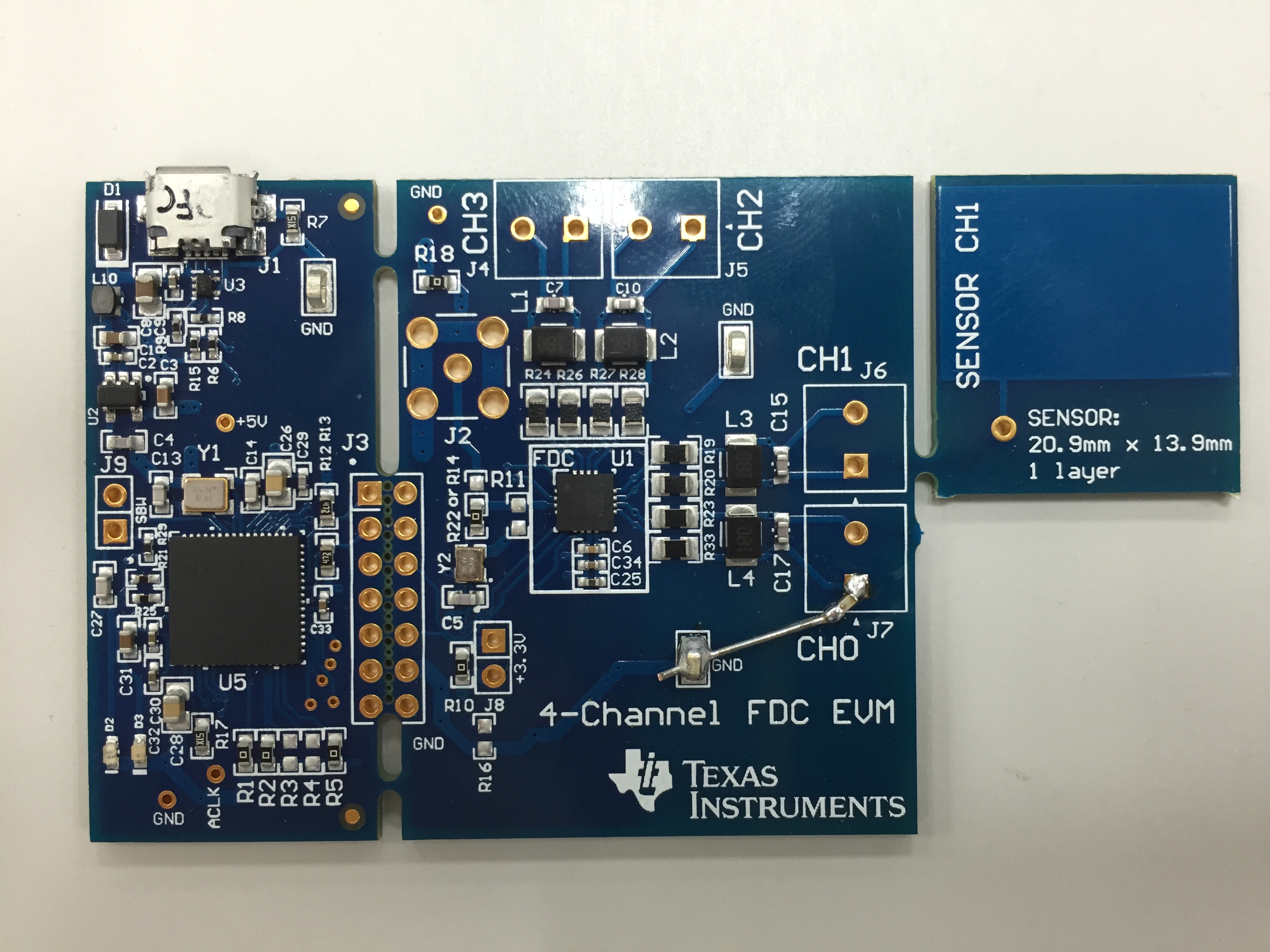

  • Dear Yibo,
    Thank you for your reply, but your answer is not correct to my experiment results.
    I mounted 100pF instead of SENSOR plate CH0.
    100pF capacitor is mounted CH0 and GND pin like attached file.
    *please see attached file
    At this time, I found that 92pF and 3.9MHz at GUI outputs.
    Therefore, I cannot think your answer that is average of two phase.
    For example, the answer will be 4.9MHz by using formula of Figure 1 like your recommendation.
    What do you think about these difference points?
  • Hello Yamamoto-san,
    Did you include the parasitic capacitance in your calculation?
    The EVM should have about 50 pF total capacitance (33pF SMD cap + parasitics). If you add the 100 pF as shown, the "effective" capacitance I calculated is 93 pF, which is very close to your measurement.
    Yibo
