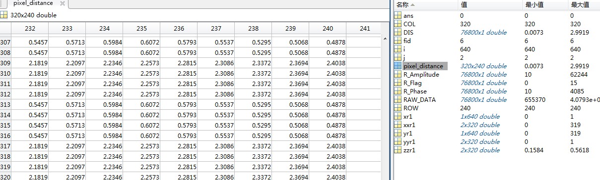

4.Get one frame data and caculate distance,the following picture shows result.
 I use the following formulas to caculate distance of one pixel.
  Phase = ((DATA & 0x0fff0000) >> 16); //DATA is 4 byte(4byte mode default)
  R = C/(2*MOD_FREQ); //C is light speed, MOD_FREQ is modulation frequency,now is 48MHZ
  distance = phase * R/4096;
5.Disable MAC_TEST,get one frame data from opt9221,and caculate distance,the following shows result
But I find most of real phase data are near to zero or 4095,what's wrong?

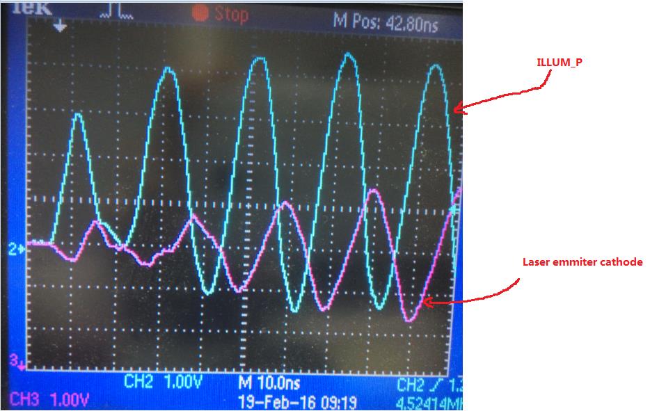

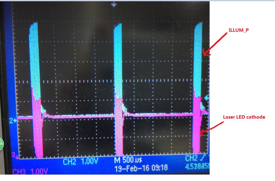

    Thanks for your reply.Now there is one laser led on my board, ILLUM_P is used for modulation ,the default modulation frequency is 48MHZ,I mesured the signal of ILLUM_P and LED cathode,the waves like follows:
    Now there is a black mount on  the opt8241 , but no lens yet.
