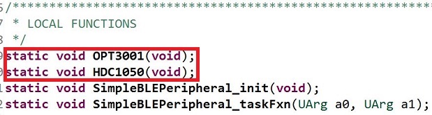

  • I add two function in SimpleBLEPeripheral.c:
    and two function behind
    void SimpleBLEPeripheral_createTask(void) { ... }
    static void OPT3001(void){...}
    static void HDC1050(void){...}

  • if I revise SimpleBLEPeripheral_init{
    OPT3001();
    HDC1050();
    data is error and not change ?

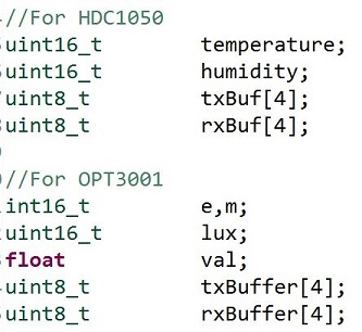

  • You should use two different rxBuffer for HDC1050 and OPT3001.
  • What do you mean "data is error and not change"?
  • Data will stop , and never change data again.
    first I define VARIABLES:
    second, I add LOCAL FUNCTIONS:

    //OPT3001
    	//Read OPT3001 Device ID
    	txBuffer[0] = 0x7F;
    	txBuffer[1] = 0x10;
    	txBuffer[2] = 0x00;
    	i2cTransaction.slaveAddress = OPT3001_I2C_ADDR; //OPT3001
    	i2cTransaction.writeBuf = txBuffer;
    	i2cTransaction.writeCount = 1;
    	i2cTransaction.readBuf = rxBuffer;
    	i2cTransaction.readCount = 2;
    	I2C_transfer(i2c, &i2cTransaction);
    	//Config OPT3001
    	txBuffer[0] = 0x01;
    	txBuffer[1] = 0xC4;
    	txBuffer[2] = 0x10;
    	i2cTransaction.writeCount = 3;
    	i2cTransaction.readCount = 0;
    	//read OPT3001 Config
    	txBuffer[0] = 0x01;
    	txBuffer[0] = 0x00;
    //HDC1050
    	//HDC1050 config Device ID
    	txBuf[0] = 0xFF;
    	txBuf[1] = 0x10;
    	txBuf[2] = 0x00;
    	i2cTransaction.slaveAddress = HDC1050_I2C_ADDR;
    	i2cTransaction.writeBuf = txBuf;
    	i2cTransaction.readBuf = rxBuf;
    	//Config HDC1050
    	txBuf[0] = 0x02;
    	txBuf[1] = 0x10;
    	txBuf[2] = 0x00;
    	//Read HDC1050 Config
    	txBuf[0] = 0x02;
    	txBuf[1] = 0x10;
    	txBuf[2] = 0x00;
    	//read HDC1050
    	txBuf[0] = 0x00;
    	txBuf[0] = 0x00;
    	i2cTransaction.writeCount = 0;
    	i2cTransaction.readCount = 4;

  • I suggest you to put OPT3001() and HDC1050() in SimpleBLEPeripheral_performPeriodicTask.
  • I revise SimpleBLEPeripheral_performPeriodicTask(void){
    OPT3001();
    HDC1050();
    but only light sensor has data , HDC1050 has no data ?

  • Since device ID can be read correct, I see no reason why temperature and humidity doesn't work. What temperature and humidity reading do you get?
  • I miss this code :
    Task_sleep(1000000 / Clock_tickPeriod);
    when I add this code in HDC1050(void){...}
    the data is reading correctly.

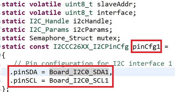

  • In bsp_i2c.c , I guess Board_I2C0_SDA1 mapping  IOID_8 , and Board_I2C0_SCL1 mapping IOID_9:
    // Assign I2C data/clock pins according to selected I2C interface 1
    if (interface == BSP_I2C_INTERFACE_1)
           i2cParams.custom = (void*)&pinCfg1;
    and SensorTag Sample code only sensor_mpu9250.c was  BSP_I2C_INTERFACE_1
    #define SENSOR_SELECT()                      bspI2cSelect(BSP_I2C_INTERFACE_1,SENSOR_I2C_ADDRESS)
    #define SENSOR_SELECT_MAG()           bspI2cSelect(BSP_I2C_INTERFACE_1,SENSOR_MAG_I2_ADDRESS)
    that mean MPU9250 is use another I2C BUS , If I am not use  bsp_i2.c , only use I2C.c , is't OK ?
  • You should use bsp_i2c.c.
