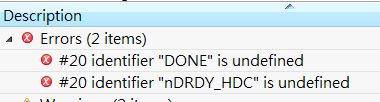

  • By the way , HDC1050 only SDA and SCL  need to define , but
    HDC1000 source code : Board.h has define nDRDY_HDC IOID_2 and DONE IOID_3 ?
  • Hi Tzuyu,
    I found a similar error due to the fact that the file board.h is not in the same directory of hdc1000.c.
    Please modify the line39 in hdc1000.c from #include "Board.h" to #include "../Board.h" and let me know if this work.
    Carmine

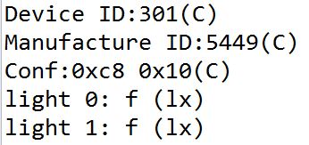

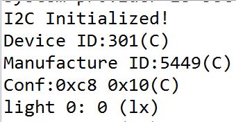

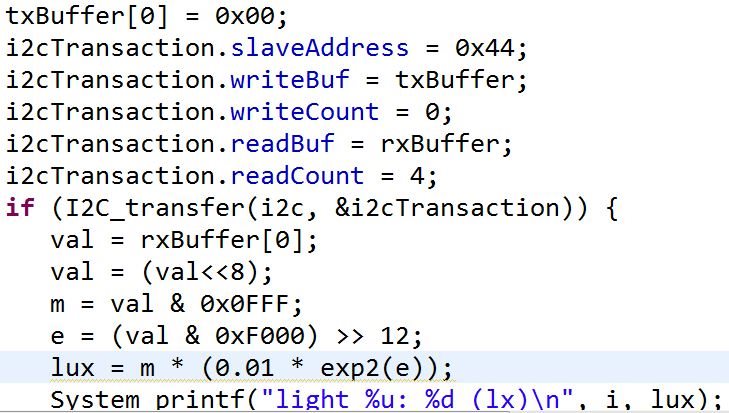

  • Try to use I2C TMP006 example for CC26xx and replace the following code to taskFxn in i2ctmp006.c.
    Void taskFxn(UArg arg0, UArg arg1)
        unsigned int    i;
        uint16_t        temperature;
        uint16_t        humidity;
        uint8_t         txBuffer[4];
        uint8_t         rxBuffer[4];
        I2C_Handle      i2c;
        I2C_Params      i2cParams;
        I2C_Transaction i2cTransaction;
        /* Create I2C for usage */
        I2C_Params_init(&i2cParams);
        i2cParams.bitRate = I2C_400kHz;
        i2c = I2C_open(Board_I2C_TMP, &i2cParams);
        if (i2c == NULL) {
            System_abort("Error Initializing I2C\n");
        else {
            System_printf("I2C Initialized!\n");
        //Read HDC1080 device ID
        txBuffer[0] = 0xFF;
        txBuffer[1] = 0x10;
        txBuffer[2] = 0x00;
        i2cTransaction.slaveAddress = 0x40;//HDC1080 ADDR;
        i2cTransaction.writeBuf = txBuffer;
        i2cTransaction.writeCount = 1;
        i2cTransaction.readBuf = rxBuffer;
        i2cTransaction.readCount = 2;
        if (I2C_transfer(i2c, &i2cTransaction)){
            System_printf("Device ID: %x%x (C)\n", rxBuffer[0], rxBuffer[1]);
        } else {
            System_printf("Device ID fail!\n");
        } else {
        //Read HDC1080 ADDR Manufacture ID
        txBuffer[0] = 0xFE;
        if (I2C_transfer(i2c, &i2cTransaction)) {
            System_printf("Manufacture ID: %x%x (C)\n", rxBuffer[0], rxBuffer[1]);
        } else {
            System_printf("Manufacture ID fail!\n");
        //Config HDC1080
        txBuffer[0] = 0x02;
        txBuffer[1] = 0x10;
        txBuffer[2] = 0x00;
        i2cTransaction.slaveAddress = 0x40;//Board_TMP006_ADDR;
        i2cTransaction.writeCount = 3;
        i2cTransaction.readCount = 0;
            System_printf("Config write!\n");
            //System_printf("Conf: 0x%x 0x%x (C)\n", rxBuffer[0], rxBuffer[1]);
        } else {
            System_printf("Config fail!\n");
        //Read HDC1080 Config
        txBuffer[0] = 0x02;
        txBuffer[1] = 0x10;
        txBuffer[2] = 0x00;
            System_printf("Config read!\n");

  • My mistake,I miss include <ti/sysbios/knl/Clock.h>
    that why Task_sleep(1000000 / Clock_tickPeriod)
    will show error.

  • the result is :
  • Are you sure that your code read raw data correctly? Do you do printf to val to check it?
  • first , I declare
    then I send txbuffer like this:
    but result is :
  • What's your point?
  • the result is 0 lx , It's impossible
  • Can you dump rawData under different light condition to see if the reading changes?

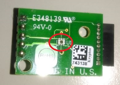

  • I guess that is light sensor ?
    maybe I am not send  txBuffer[0] = 0x00;
    It's wrong ?
    for(i=0; i<20; i++){
    txBuffer[0] = 0x00;
    i2cTransaction.slaveAddress = 0x44;
    I2C_transfer(i2c, &i2cTransaction);
    Task_sleep(1000000 / Clock_tickPeriod);
    txBuffer[0] = 0x01;
    i2cTransaction.writeCount = 0;
    i2cTransaction.readCount = 4;
    val = rxBuffer[0];
    rawdata = (val << 8) | (val>>8 &0xFF);
    m = rawdata & 0x0FFF;
    e = (rawdata & 0xF000) >> 12;
    lux = m * (0.01 * exp2(e));  //show exp2 declared implicitly ?
    System_printf("light %u: %d (lx)\n", i, lux);
  • 1. Yes, U1 is OPT3001 light sensor.
    2. Try to following code:
    txBuffer[0] = 0x01;
    txBuffer[0] = 0x00;
    val = rxBuffer[0];
    lux = m * (0.01 * exp2(e)); //show exp2 declared implicitly ? You have to include math.h
    System_printf("light %u: %f (lx)\n", i, lux);

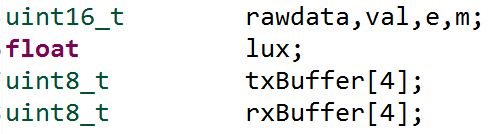

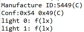

  • Do I miss some thing?
    The light still no value:
    I also declare rawdata val e m is uint16_t :
  • Try to write Configuration Register to 0xC4 0x10.
  • writeCount should be 2 and readCount should be 0.
  •    txBuffer[0] = 0xC4; //config
       txBuffer[1] = 0x10;
       i2cTransaction.writeCount = 2;
          System_printf("Conf:0x%x 0x%x(C)\n",rxBuffer[0],rxBuffer[1]);
       }else{
          System_printf("Config ID fail!\n");

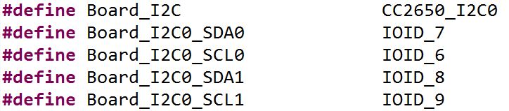

  • Now ,I use IOID_7 and  IOID_6 , if I want to use  IOID_8 and  IOID_9 , what do I do?
  • Just change Board_I2C0_SDA0 to IOID_8 and Board_I2C0_SCL0 to IOID9.
  • May I just straight use Board_I2C0_SDA1 and Board_I2C0_SCL1 ?
    I can let HDC1050 use IOID_8 and IOID_9 , and OPT3001 use IOID_7 and IOID_6 .
    no clash.
  • I think it should be OK.
  • I try to let OPT3001 use IOID_7(SDA) and IOID_6(SCL) , my code need to open I2C :
    i2c = I2C_open(CC2650_I2C0, &i2cParams);
    but of I want to HDC1050 use IOID_8(SDA) and IOID_9(SCL),
    should I need to revise i2c = I2C_open(CC2650_I2C0, &i2cParams) ?
  • Yes, you should do it.
