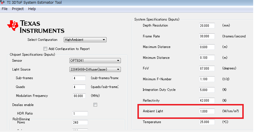

Q3) SYSTEM ESTIMATOR TOOL
About the tool, the "Ambient light" setting is "1.000W/nm/m2" by default under the "High Ambient" configuration as below.
Can I understand that this value is the same as "100K lux" as under the strong sunlight?

    Q3 - About the ambient light value in System estimator tool
    The spectral content of 850nm light at 100k lux sunlight is approximately 1W/nm/m^2

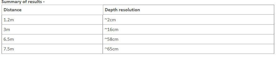

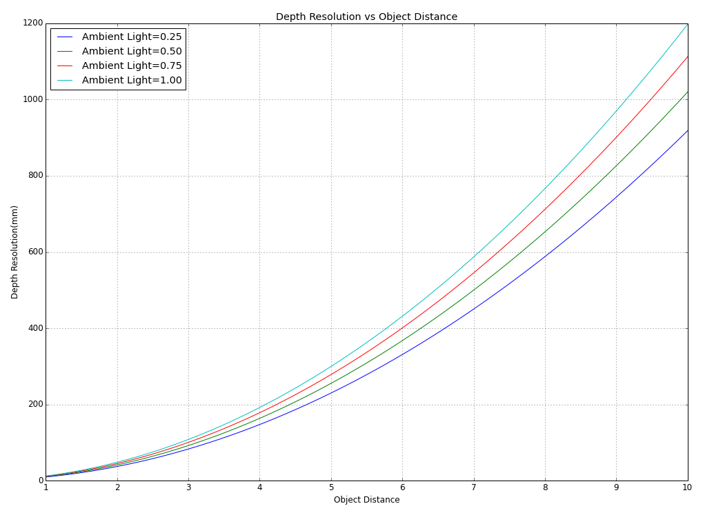

    Q5- experiment data for high ambient ( 50k lux ) with OPT8320
    Simulation data using system estimator tool
    Summary of results -
    Distance
    Depth resolution
    1.2m
    ~2cm
    3m
    ~16cm
    6.5m
    ~58cm
    7.5m
    ~65cm
    As can be seen from the above results, actual results and simulations match very closely.

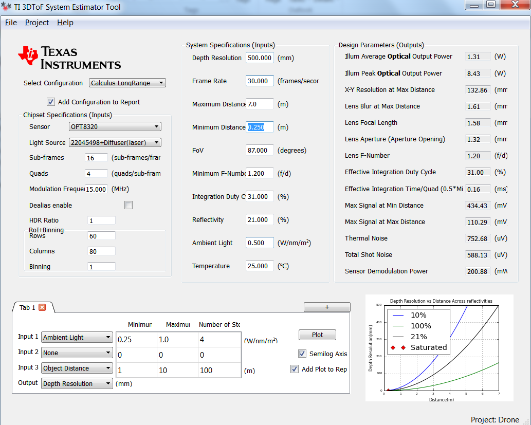

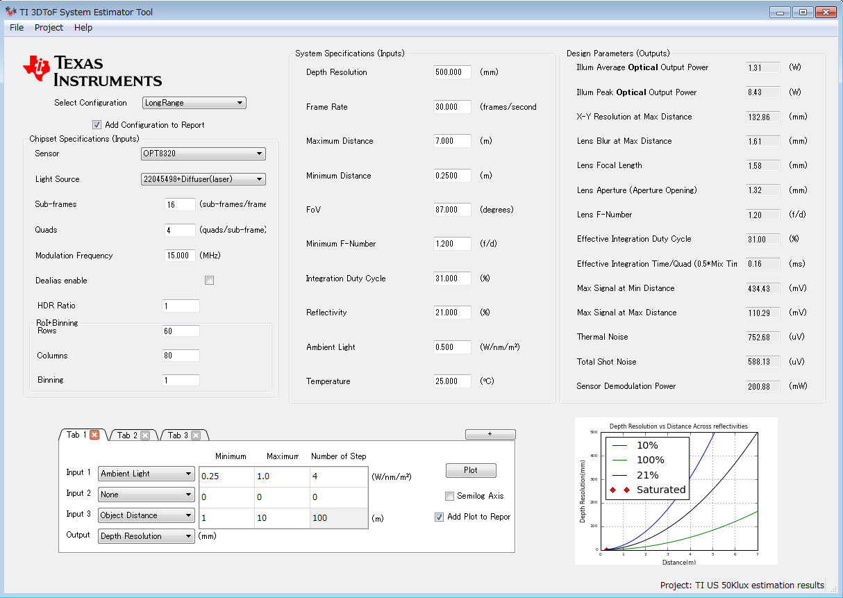

    I tried to use estimation tool to confirm your settings.
    The followings are my setting display and result.
     Are both setting and result correct?
    And the following your data is an actual data by using OPT8320, right?
    Did you compare this data with estimator's result (Green data = Ambient light 0.5)?

  • Hi Takumi San
    Both the setting and the results are correct. Data given in the table is the actual data by using OPT8320.
    Both simulation data and actual results are comparable. Actual conditions generally vary from simulation conditions. So kindly use the system estimator as a starting point and design with a tighter requirement in the simulation to allow for this margin.
