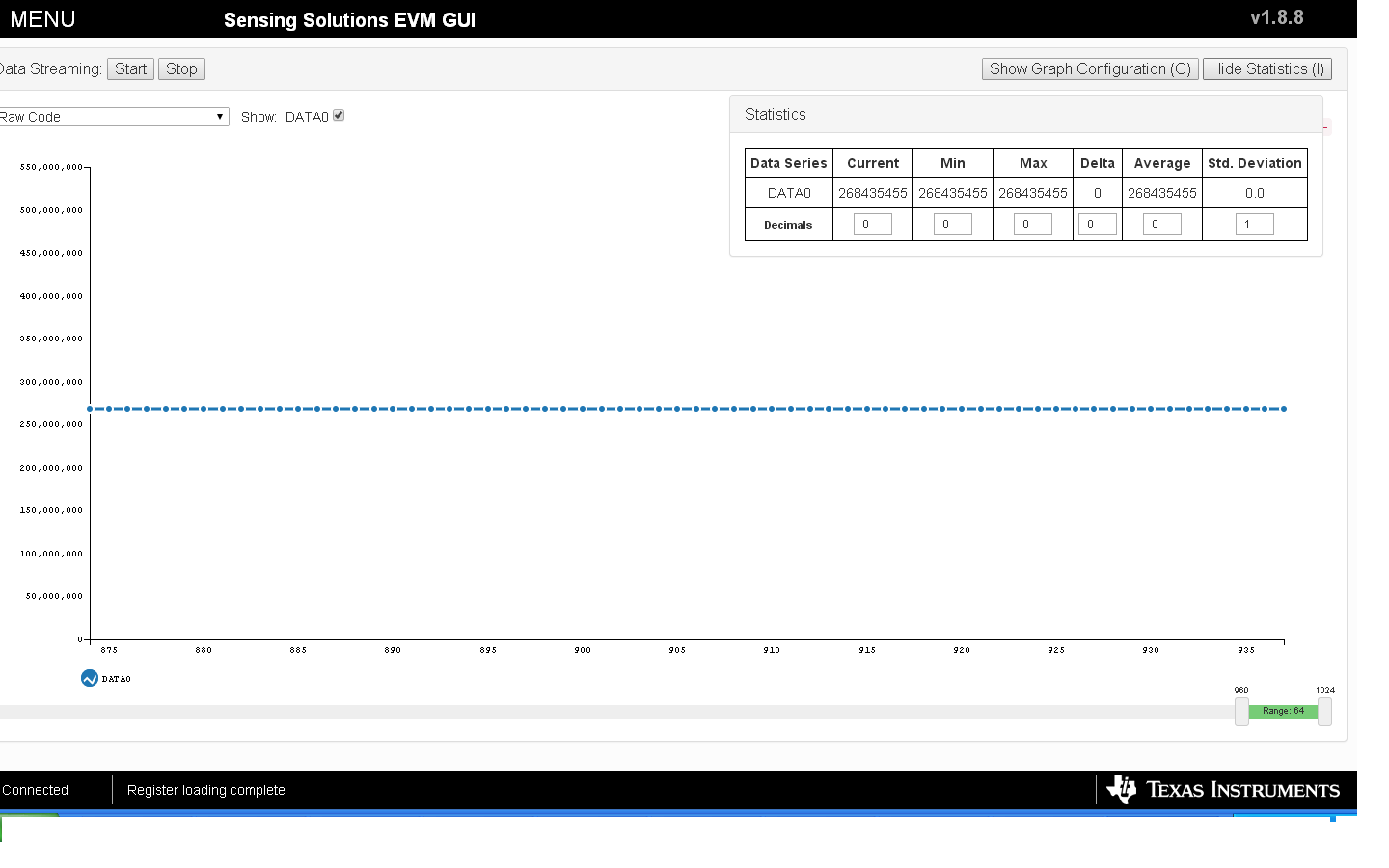

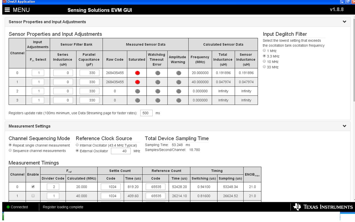

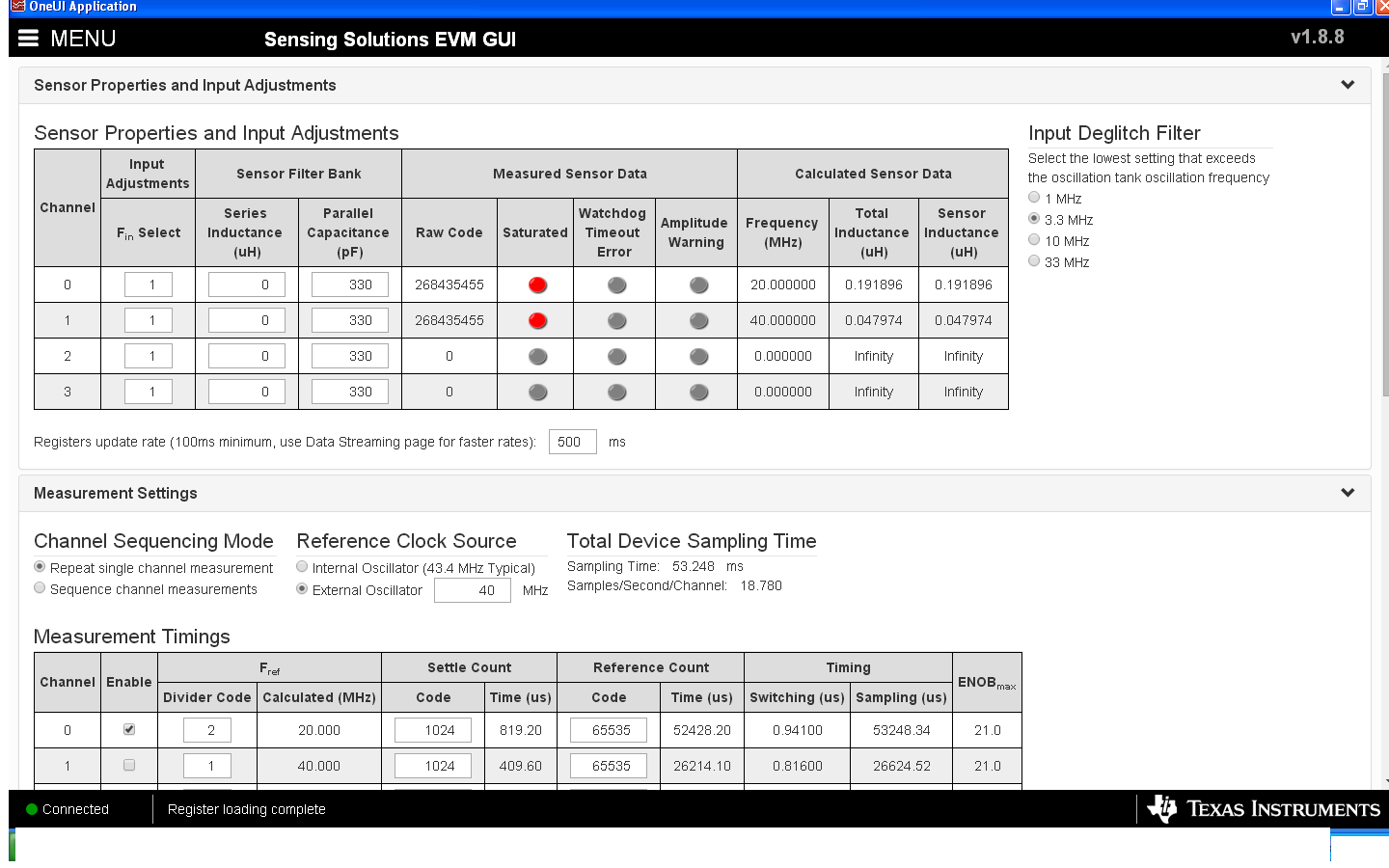

  • Hello Ben,
    I was able to connect  my board 2 with TI EVM and I found that the channels are shown as saturated.
    The data loged also is static, it doesnt detect any object as well
  • Hello Yeshwanth,
    1) do the EVMs work unmodified with TI software and the latest TI firmware?
    2) can you try to assert SD and then de-assert SD before attempting to wake up the device from sleep?
    3) the GUI shows that the calculated sensor frequency exceeds the maximum supported frequency. This means that either the firmware is old, the connected sensor is invalid (violates datasheet specification), or that I2C communication is faulty.
  • Hello Ben,
    The evm works when reassembled with actual TI board(LDC1614 and coil unit)
    2) I tried with asserting SD and de-Asserting SD, it did not work. May be the IC is at fault.
    3) I have cross checked my calculations they do match with the requirement, where else could I be going wrong ?? Could the method of soldering be the cause of malfunctioning??
    Yeshwanth Kumar J
  • Hello Yeshwanth,
    I don't believe that the IC is at fault because it worked when you re-connected it to the TI EVM. The sensor doesn't seem to be the issue either, you should be able to get the part into and out of sleep mode regardless of the sensor.
    Please compare schematics and probe nearby components of both your PCB and the EVM with a scope to narrow down the problem.
    Also, please verify that I2C pull-up resistor values, protocol and timing are correct, and compare with the EVM.
