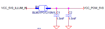

why there have so lagre Cap 1.5mF in the OPT8241_CDK_EVM?

Hi Ti,
     why there have two  so lagre Cap 1.5mF in the OPT8241_CDK_EVM? just like bellow:

  • Hi
    The two huge caps are for energy buffering. During integration time, the high current required by the laser diodes are supplied from these caps.

  • Hi None_feiu,
    High current meant the current the forward current current through laser diode during integration time. Because of the presence of the inductor , average voltage at the ouput of the current source = 4* VF*0.5
    I will show an example case for determining the energy buffering required.
    Now you have to decide , what is the maximum integration time you are allowing. If I assume 100uS of integration time,
    Assuming
    VF =2.4 V per laser at 2.5A
    Energy taken up by the lasers = 2*2.4*2.5*100u = 1.2mJ
    Now you have to account for the losses in linear source as well as in the switching mosfet.
    losses in mosfet = 2.5A^2*27m Ohm * 50uS = 8.4 uJ
    Assume that you are allowing 150 mV drop across the linear current source .
    Losses in linear current source = 150mV*2.5A*100uS = 37.5 uJ
    Hence take total losses as say 50mJ
    Total energy required = 1.25mJ
    Initial voltage in Capacitor V1 = 5V
    Here say I am ready to allow a max drop of 150mV
    Final voltage V2 =4.85 V
    Now as you suggested
    .5*C*(V1^2 - V2^2) =energy required = 1.25mJ
    Hence C = 1.7mF
    Assuming a derating factor of 0.8 , required capacitor become 2.12 mF.
    Assuming a safety margin , two 1.5mF capacitors are connected in parallel.

  • Hi None_feiyu
    the capacitors act as a fall back in case the input current could not be 2.5A. For example, OPT8241_CDK can be used on USB only input. In that case ilium board gets 100mA input only. Then this current is supplied by the capacitors.

  • Hi None
    The lasers may work upto 4.5V. We have set 100mA current limit to illum board so that we can support higher integration duty cycles in general. As long as you are able to replenish the capacitor, you should be okay. With 50mA current limit, you will be limited to lower integration duty cycles.

  • Hi Nithin,
    I know what you mean, in my opinion,as long as can able to replenish the capacitor in the time t=(Quad time - integration time),so the 50mA current will be ok.
    About the time t=(Quad time - integration time) what my understand is right or not?
    Thanks&regards
    None
  • Hi None
    Your understanding is right.
