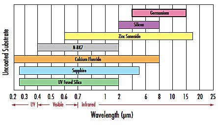

  • Hi Dan,
    That spacer sounds about right.
    Here is a chart of materials that can used as a window material (not IR filter material as mentioned earlier). We are mainly interested in the 4-16um range.
    The material we have characterized as a window material is polyethlyene and have found good success with it.
    -Michael Wong
  • Polyethylene  also passes visible light. I'm under the impression I should be looking for a window material that blocks the visible light spectrum and paases the THERMAL IR spectrum (3 - 16 um) which the chart shows either Germanium or Zinc Selenide being the best choices.
    Have you (T.I) tried these other materials? Is Polyethylene 'good enough'?  Which way am I going?
    Dan Ross
  • Hi Dan,
    The TMP006 will only detect IR spectrum wavelengths (4-16um) and does not care about the visible light spectrum. In my posts above I made the mistake of mentioning polyethylene, it should be polypropylene, I keep getting those two mixed up. The specific material we have tried is this one: www.edmundoptics.com/.../.
    Also check out this other E2E topic that covers a lot about IR windows: e2e.ti.com/.../1666830
