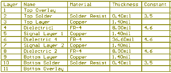

Q5) The LDC0851EVM's PCB infomation?
How lmany space between 1st layer and 2nd layer(x12)
How many space between 2nd layer and 3rd layer(x23)
    The EVM is a 4 layer PCB where the spacing between the 1st and 2nd (x12) is 8mil, x23 = 36.6mil, x34=8mil. The layer stackup is shown below:
