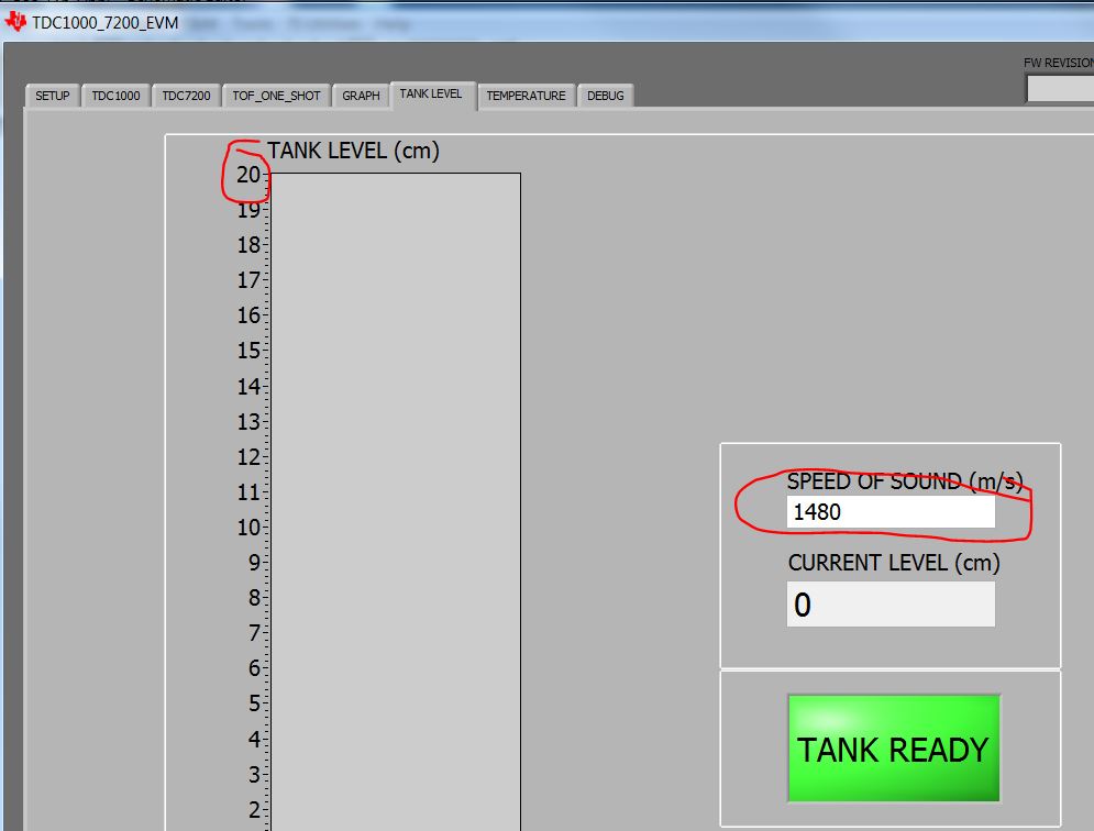

How do you connect an LCD display to the TDC1000-TDC7200 EVM for it to display the level in a tank? what equipment/programs are needed?
Also would it be possible to take a value X away from the time of flight value being transmitted before the time of flight value is converted into a level (in millimeters/meters)?
  • Martin,
    The present TDC1000-TDC7200 EVM GUI already has the capability to convert a TOF measurement into a distance. See below:
    Once you enter the Speed of Sound in the box (circled above) the distance is displayed in meters. You can set the diplay range by changing the red circled graph limits as well.
    LCD-wise that really depends on your skill set. You could connect a LCD display with an UART interface to the board and reprogram the MSP430 to output distance data to the display. At present the MSP430 will output TOF data from a pair on pins on the EVM. You would need to reprogram the MSP430 to output distance calculations vs. TOF data.
