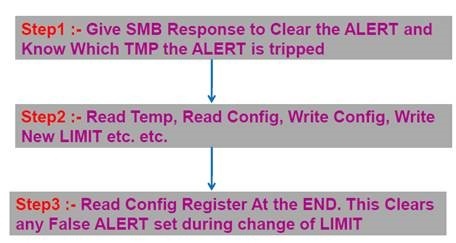

    Reply > According to the datasheet this is correct. That is, if the last statement is referring to a general call reset command. Reading other registers or writing to the configuration register will not clear the ALERT output.
    I found this comment:
    After Writing Limits Always READ the CNFG register, Because that will Clear Any
    ALERT set during Writing. READING OF CNFG reg is MUST after LIMIT Update
