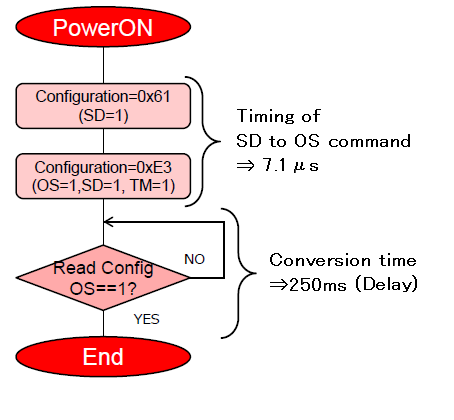

Please let me know about shut down time.
①How much time will SD command complete time?
②Is SD command necessary to time margin (waiting) before next command?
【Customer information】-------------------------------------------------------------------

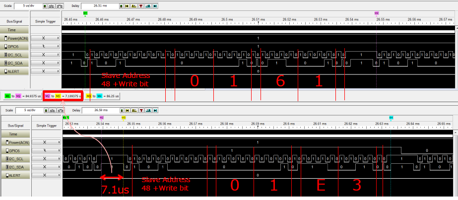

・When SD:1(enable) and momentarily(7.1μs) OS:1(single conversion), conversion complete was delay.
 Delay time is about 250ms.

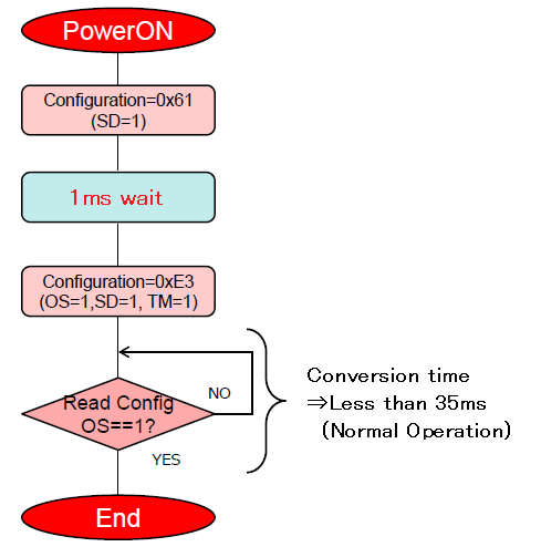

・If 1ms waiting after SD command, TMP102 was normal operation.
・I2C:400kHz
・Flow chart is attached
Best regards
Satoshi

    The moment you write a shutdown command while the devices is converting; the device will shutdown at the end of each running conversion. All the changes of the features execution will affect after the current conversion is completed.
    Hope this helps!
