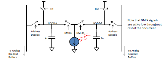

In your User's guide (from May 2014) you are presenting the following model of the pixel (figure 2). Thus my first assumption was, that two phase windows (180° shifted form each other - controlled by signals DMIX0 and DMIX1) are measured within one quad. But with the information, that there are both frequencies in one quad I am not sure anymore.
So are there really two frequencies AND two phase windows measured within one quad?
If so, then how? There would be 4 different information - f1φ, f2φ, f1(φ+180°),f2(φ+180°). I can imagine it with either two additional "capacitors" to store the information OR additional read-out and reset after the f1 is finished.
Figure 2 - Simple model of the pixel
3) Which phase windows are being used for both single and dual modulation frequency?
All my assumptions here are essentially dependent on the answer on the previous question.
But just for Illustration of what I mean:
Lets say that for single mod.f we have 4 quads within one sub-frame and the pixels are working according to figure 2. Is it then correct that in the first quad there are windows of 0° & 180 ° shift from the reference signal, then for second quad 90° & 270 for the third 180° & 360° for the fourth 270° & 90°?
Wouldn't the 3. and 4. quad be redundant when they are actually the same as 1. and 2.?
And which phase windows are used for 6 quads and dual modulation frequency?

  • Martin,
    Sorry!
    Unfortunately, we cannot share more details on the internals in a public forum. We will need to sign an NDA.
    You can mail us at ti-3dtof@list.ti.com. We would like to understand the applications that you are targeting and the business case before we continue.
