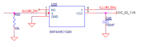

Hi ti,
This is laser mos driver,the TRIG is ILLUM_P signal,From Datasheet,it is reference 3.3V voltage.
I am confused,why mos diver VCCA not connect to 3.3V but to 1.8V?
hope you reply.

Hi None,
Thanks for pointing this out. "Trig" is a 3.3V level signal whereas we have used a 1.8V VCCA on the level translator. This seems to be an error.
Please connect 3.3V supply to VCCA in your design.
Subhash
Hi None,
VCCB voltage would have to be set to a high enough value such that the Rds for CSD16301Q2 is low enough. As VCCB increases, the MOSFET Rds reduces. So we keep VCCB at a voltage > 1.1V.
You can also attempt both 3.3V and 5V in your board design. It is possible that you get a better response if you use 5V for VCCB.
