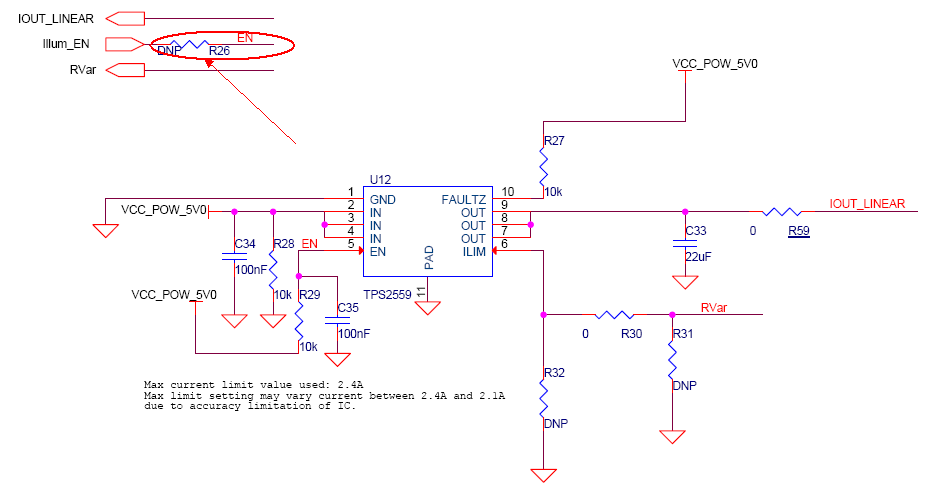

Hi TI,
I think it is better set R26=0Ω,why thers is not connect.
thanks®ards.
Hi TI,
thanks®ards.

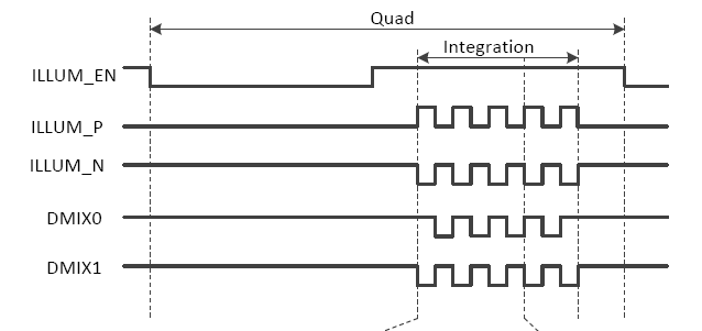

Hi None,
If you look at Table 8.6 of TPS2559, the output voltage turn on time for the Enable input is up to 15ms. We cannot have such a delay in the activation of TPS2559 as integration time within a quad are much shorter than 15ms.
Subhash
