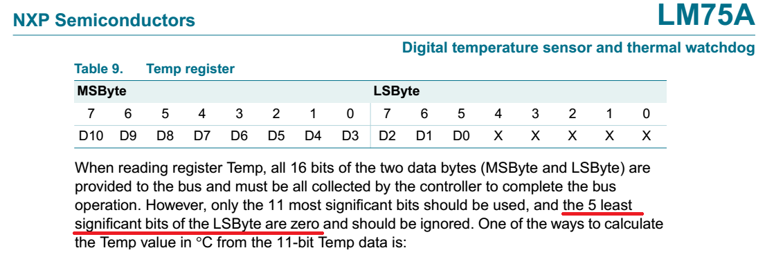

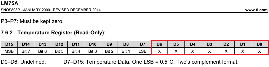

Can you specify these "undefined bits" either "0" or "1"?
Some of market devices like LM75A from NXP, it's described in that datasheet that these undefined bits are "0".
Thank you for your support in advance.
