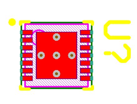

hi All,
Does the pad of the LM95214 must be connected to GND or lef floating.
there is any indication in datasheet about that.
Thanks in advance.
Hervé
  • Hi Hervé,
    For sensors in plastic packages such WSON, the leads provide the dominant thermal path as well as the DAP. I attached the LM95214 layout footprint FYI. As you can see, we connect the DAP through a via, which connects to GND.
    Hope this helps!
    Aaron
