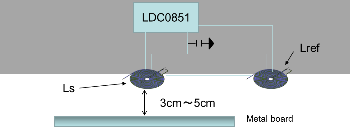

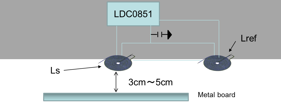

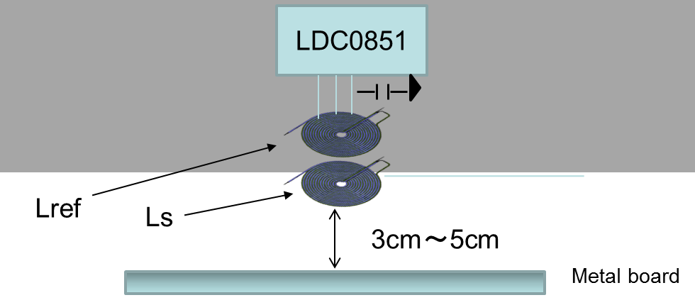

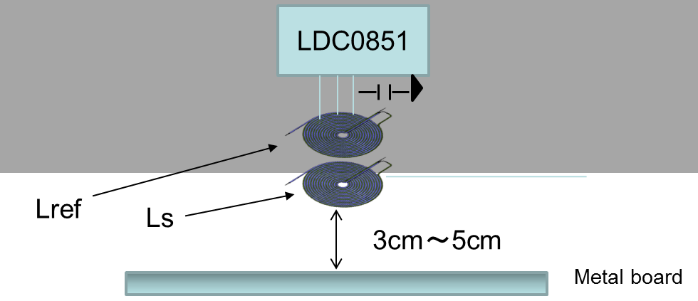

We assume the following system.
CASE:1
CASE:2
The purpose of this system is just to detect the metal board.
Distance between target metal board and sensor is about 3cm ~5cm.
So, we need information how to design coil.  Could you please advise us?
1. What do you think which coil placement case is better, case1 or case2?
2. We have LDC0851EVM and LDCCOILEVM. So, we want to start evaluation.
What do you think which coil size and capacitance should be chosen?
3. We can use LDC calculation tool (excel sheet).
If possible, could you feedback how to design coils as example?
Best Regards

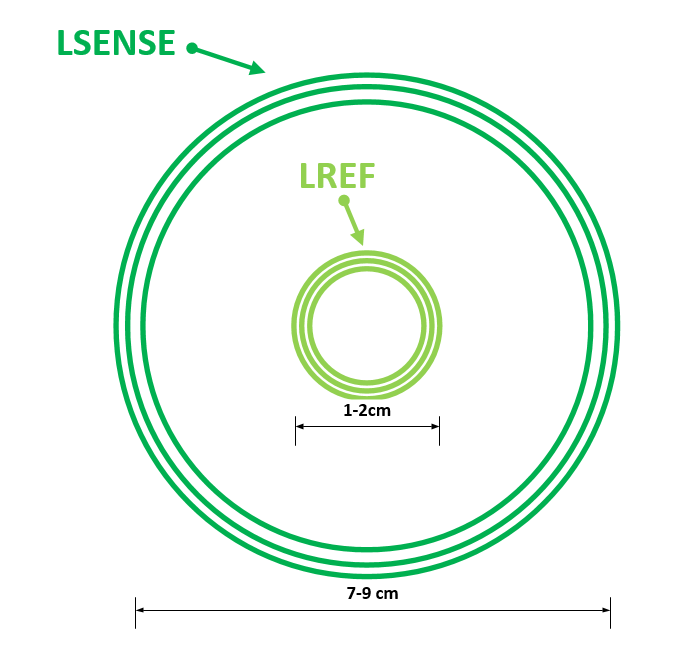

  • Hello Na,
    That's perfect. This actually simplifies things a lot.
    Since you are already familiar with the LDC spreadsheet and Webench design tools, I can recommend the following configuration:
    You should design a spiral LSENSE sensor so it falls in the LDC0851’s design space, and calculate it’s inductance at the switching distance using the LDC Tools Spreadsheet, let’s call this value X.
    Once you have figured out X, design a much smaller coil with the inductance value of x which will be your LREF sensor. You can place the coils concentrically as in the picture above.
    Varn Khanna,
    Applications Engineer, Sensor Signal Path,
    Silicon Valley Analog,
    Texas Instruments,
  • Hi Varn,
    will this configuration really work? I believe that inductunces of those coils should be identical.
    Igor Gorbounov

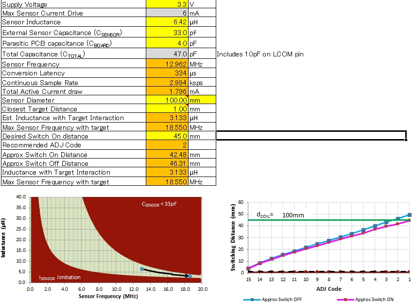

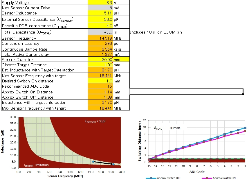

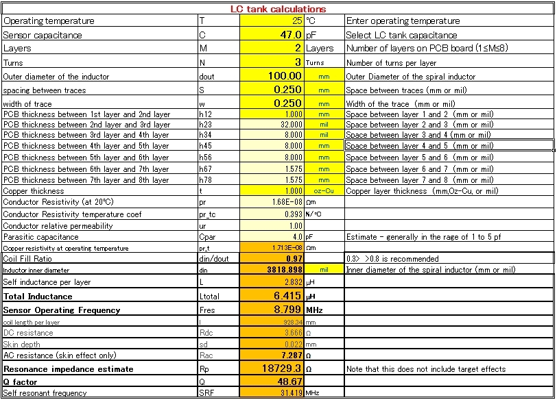

  • Hi Varn
    Thank you for your reply.

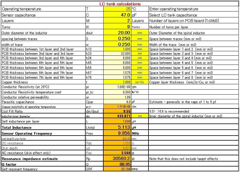

    Could you check our calculation results?
    ■For Lsense
    - Spiral inductor designer
    -LDC0851 calc
    ■For Lreference
    -LDC0851 calc
    BestRegards
  • Hello Na,
    Please accept my sincere apologize for the delay in getting back to you.
    Excellent work! I am glad you got good use out of our design tools.
    I think I didn't explain the reference sensor config well enough. You want the free space inductance of the REFERENCE sensor to be equal to the inductance of the SENSE sensor at the switching distance. So in this case, if you want to switch at 3cm away from a rough estimate you want the REFERENCE sensor inductance to be around 6uH. For 4 cm switching distance your reference inductance would be ~6.22uH.
    Could you also confirm how close does the metallic target get to the sensor?
    Varn.
