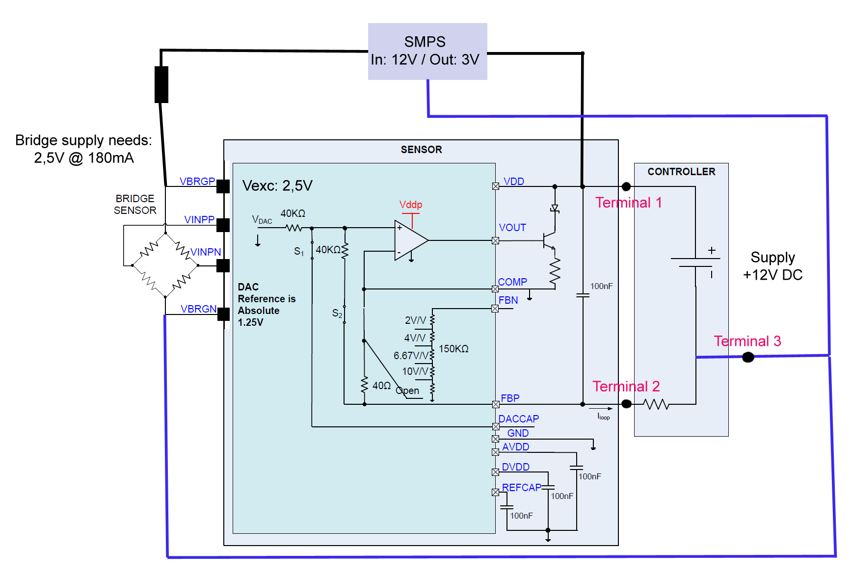

We want to design a 3-wire transmitter, but the supply current for our sensor needs to be higher than the maximum PGA900 excitation current. The inputs to our circuit are the following ones:
-        Positive supply (+12V DC)
-        Negative supply (GND for the positive supply)
-        Signal output (4..20mA)
We have tried to follow the TI’s reference circuit but our problem is that our bridge sensor is a catalytic gas bead and it needs about 180mA of excitacion current. TI’s design is made for 2-wire transmitters and ir our case, we could work with a 3-wire connection because we have a direct connection to the supply GND. We will like to separete the 4..20mA signal from the supply line return path.
Please, see attached file with a circuit proposal. We are not sure about the current return paths. Where should we connect the return path (GND) for the SMPS converter and for the VBRGN terminal?
