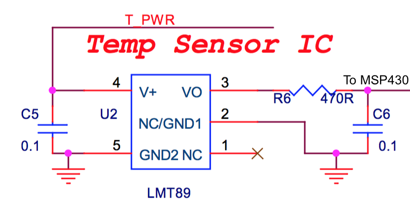

    We are using the LMT88 / LMT89 chips directly in the board of our device, and it was wired up as recommended in their datasheets. Please see the annotated sub-schematic below. The output is connected to the ADC of a MSP430 chip. T_PWR is connected to one of the output pins on the MSP430. We then take the detected voltage value and apply the conversion formula in the datasheet, which is actually the same for LMT88 and LMT89 chips.

  • Hi Michal,
    Your schematic is correct and I cannot see any problems with your method of interfacing with the MSP430. The ADC in the MSP430 series of microcontrollers come in a variety of flavors, can you describe the ADC characteristics (# of bits, reference voltage level, type, etc) or provide the MSP430 part number?
    Just to do some more trouble shooting, can you measure the output of the LMT88 and LMT89 with a voltmeter and verify if they match up to Table 1 in their respective datasheets. Next compare this voltage measurement to the voltage reading from the ADC and see if both readings match.

  • Hi Michal,
    The LMT88/89 can only sink current they cannot source it. If your try to pull current out of the output the output will go high thus indicating a colder temperature but that is not your case as you are reading consistently hotter temperatures. You may want to try a pullup resistor to VDD to see if that is the problem. I think the cause of your issue is probably the ADC input sample and hold. We have had to increase the acquisition time and lengthen the time between conversions for a similar device in order to make the device work properly. You may also need to play around with C6. If you sample too fast it causes the charge on the cap to deplete as the temperature sensor output does not have enough time to recover.

  • Hi Soumil,
    The schematic of your system and your sampling times seem good to me. I am beginning to think your problems may stem from the error specs of the ADC10. Quickly looking over the MSP430G2553 user's guide shows special calibration values for the internal ADC that nulls the offset and gain errors. The user's guide only mentions specifically a ADC12 example but shows ADC10 is available as well, you may have to ask the MSP430 on the details on that. I believe getting rid of those ADC errors will improve the accuracy significantly.
