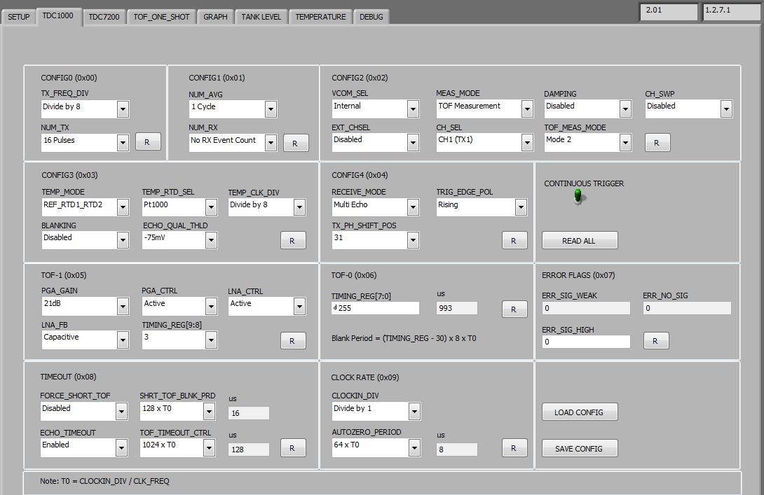

  • Hello Sir,
    I am using TDC1000 TDC7200 EVM for contamination identification in water. I am currently using two  Steminc 15mm 1Mhz transducers. These transducers are mounted on opposite sides of plastic container of width 9.5cm using a CA glue.
    These are my registration configuration for TDC1000.  TDC7200 is operated in measurement mode 2 and the trigger update frequency is 500 ms.
    I have connected my CRO probe to COMP_IN pin and I am seeing maximum peak to peak amplitude of 200 mV for PGA gain of 21 dB. But I am not seeing stop pulses or TOF is not measured.
    Please tell me if there are any mistakes in configuration of TDC1000, TDC7200 or mounting and choice of the sensors
    Thank you
  • You have selected TOF measure mode as Mode 2 in CONFIG2 register. Mode 2 is for flow measurement. Mode 1 is for the pitch/catch configuration you are trying with 2 transducer in which one sends and the other receives.
    Also, for concentration kind of application you can start with 1 transducer in mode 0. As the container width is fixed, the TOF is dependent on the concentration. There's an app note on that.
