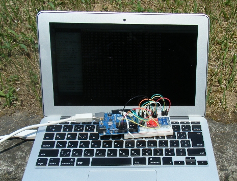

    Thanks for your reply. I used a CC2650STK which was removed the housing. But same result. a picture is here: twitter.com/.../752702350855327744 . And the module using a TMP007 also outputs same results. The site of that module is here: www.adafruit.com/.../2023 .

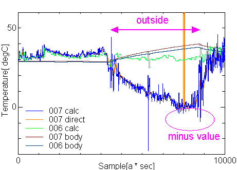

    Yes. I saw negative object temperature and negative sensor voltage like a attached picture. In this picture , a blue line is a plot of calculated temperature using voltage value. when I took out a TMP007 from my office building, the die temperature ("body" in the picture) increased but the object temperature decreased.
    I can make out that a thermopile makes a Transient Error when it was heated. But I cannot understand a difference of behavior on TMP007 and TMP006.
    Is that difference of characteristic in between TMP007 and TMP006?

  • There is a small sensitivity difference between TMP006 and TMP007. There is also device-to-device variation within our specified limits.

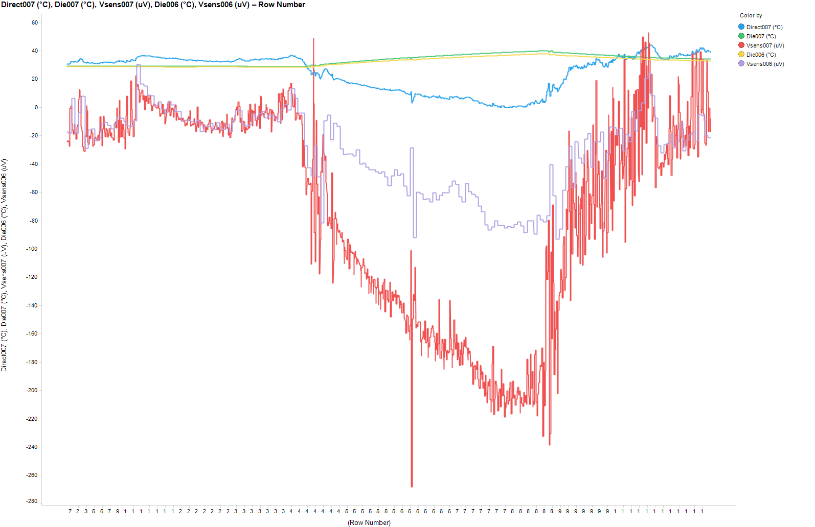

  • Your software does not correctly decode the negative voltages. You report Vsense -0.00 when the device reports a negative number (two's complement.) Your TMP006 and TMP007 die temperature and sensor voltage are very similar when voltages/temperatures are decoded correctly. For most of the log, the devices track each other. When pointed at the sun, the device die temperature begins to ramp up. The sensor is often confused when it's die temperature is changing, because the object temperature depends on cold junction compensation. In this case, the data tells us that the thermopile is colder than the device temperature. The IR energy from the sun is being absorbed by the device and rapidly heating the silicon, but the thermopile is (by design) somewhat isolated from this. This isolation causes the thermopile to lag behind in temperature.

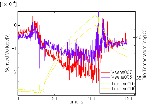

  • Both TMP006 and TMP007 have the same thermopile. In your data, TMP007 die heats faster and reaches a higher max temp. We can speculate that this happens because of slight shade, hot spots, or simply that the TMP007 has a larger surface area to absorb energy with.
    During this time that the devices are heating, the TMP007 has a larger negative voltage than TMP006. This makes sense, because the difference in device temperature and "object" temperature is greater. I say "object" because there is no object to measure. You won't be able to measure the sun's temperature. Most of the medium wavelength IR that is used in temperature measurement is blocked by the gases in the atmosphere. This means there is a lack of IR energy to be measured by the sensor when it is pointed at the sky.
    Ren
