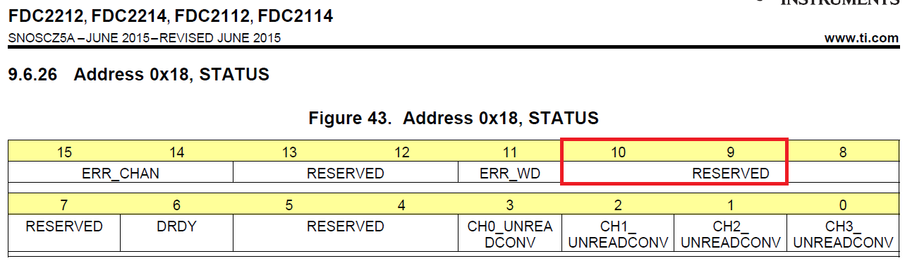

The bits of ERR_AHW and ERR_ALW in the STATUS Field Descriptions(0x18) have been kept 0b evne if the bits of AH_WARN2OUT and AL_WARN2OUT in the ERROR_CONFIG(0x19) are set to 1b, the bits of CHx_IDRIVE in the DRIVE_CURRENT_CHx are set to the minimum or the maximum value by using the arduino.
So, could you please tell us how to report the amplitude high and low warnings ?
