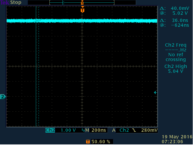

    The CFA pin settles to a DC voltage of 1.5V and the CFB pin settles at 5V. The sensor pin shows sine wave oscillation at ~4.2MHz with the target present.
    Below are the waveforms attached
    Tank One end:
    CFA:
    CFB:
    The filter capacitor used in 10pF and they earlier had tried with a 22pF also.
  • Hello Mahesh,
    it appears that the RP of your sensor is too low. This is the reason why the CFA/CFB is saturated, and the oscillation amplitude is only 1V, even though the register is set for 4V. Please verify that the sensor RP is within the specified limits.

  • Hi Mahesh,
    if there is no GND cut-out on the other layers, then your performance and sensing range will be seriously impacted. The GND flood acts as a second target which is much closer to the coil than the intended target. I recommend re-spinning the PCB and ensure a GND cut-out on the other layers.
