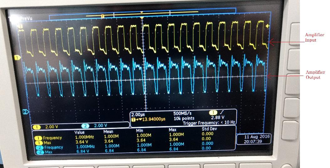

I am working on Ultrasonic Transducer testing for water flow measurement and I am using TDC1000-7200 EVM and OPA2211 for Amplification in between EVM TX1 output(J5.1) and Ultrasonic sensor.
When I connect TX1 output of TDC1000-7200 EVM to OPA2211 Amplifier input and I received waveform as per below image.
Waveform shown in channel 1(yellow waveform) were pure square wave without edge distortion before EVM connection. By connecting OPA2211 Amplifier at output(TX1) of TDC7200-1000 EVM input signals to opamp got distorted as shown in above signal(yellow waveform) so output of amplifier too.
Is that loading effect from TDC1000-7200 EVM(OPA2211 based amplifier circuit is tested and working good from different external source)?
Please suggest best solution to remove distortion.
