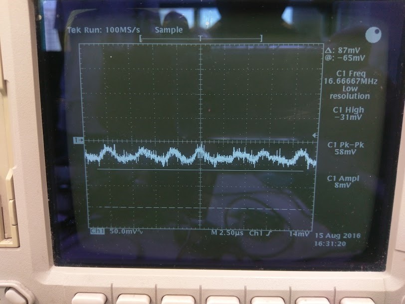

Also we have check the power noise cause a temperature error, power supply ripple is about 80mV, it seems ok.

  • Hi Jason,
    80mV of supply noise is rather marginally high. Do you have a bulk bypass capacitor such as 1uF or larger on your board? If not I would suggest adding one.
    It seems you have the part setup properly can you share your schematic?
