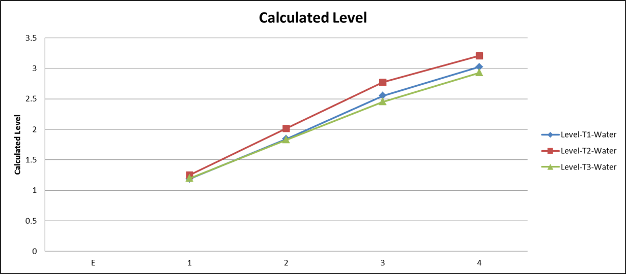

We tested water level sensing using FDC2214.
And we got the following result.
TEST1 Level Up
Ref (pF) Level (pF) Level-T1-Water
Empty 85.371 87.209
1 cm 85.703 87.604 1.189759036
2 cm 85.787 87.977 1.846153846
3 cm 85.806 88.319 2.551724138
4 cm 85.811 88.541 3.027272727
TEST2 Level Down
Ref (pF) Level (pF) Level-T2-Water
Empty 85.412 87.261
1 cm 85.69 87.609 1.251798561
2 cm 85.766 87.975 2.016949153
3 cm 85.792 88.315 2.773684211
4 cm 85.811 88.541 3.20802005
TEST3 Level Up
Ref (pF) Level (pF) Level-T3-Water
Empty 85.294 87.136
1 cm 85.653 87.567 1.200557103
2 cm 85.735 87.943 1.829931973
3 cm 85.763 88.287 2.454157783
4 cm 85.77 88.531 2.930672269

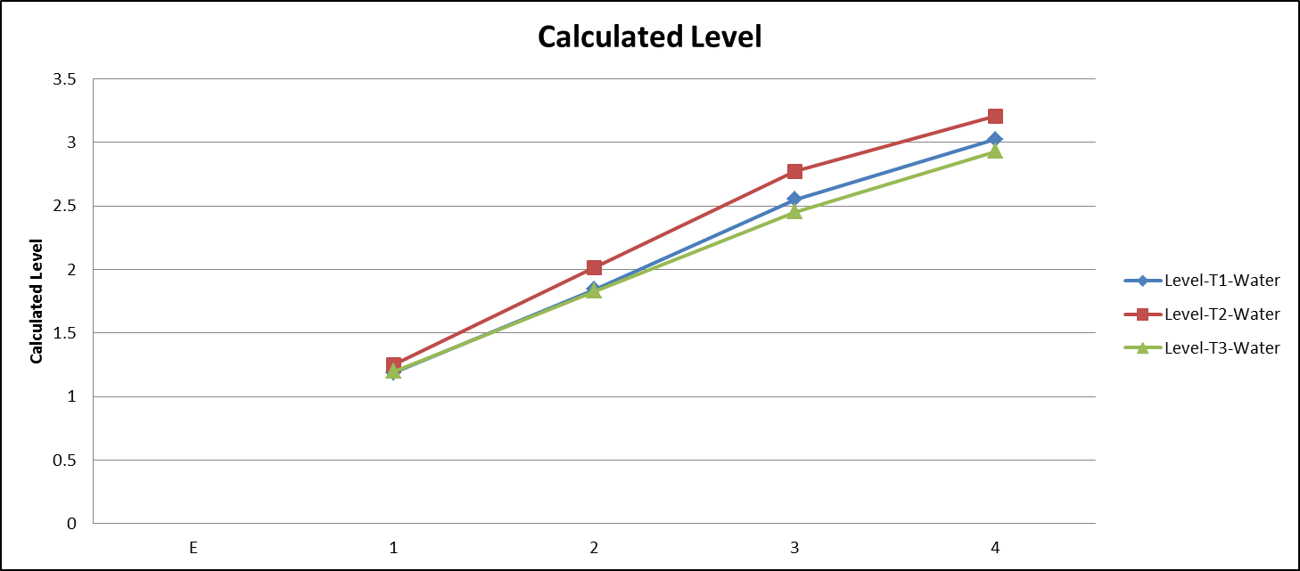

To obtain the calculated level, we used the following:
where
href = 1 cm,
Cre is capacitance of reference liquid electrode when tank is empty, because environmental electrode was not used.
We have tested 3 times with same environment.
In the TEST1, water level had increased (level up).
In the TEST2, water level had decreased (level down).
And water level had increased again in the TEST3 (level up).
We think the result of TEST2 is a little different from the other results.
Question:
What do you think the results we obtained?
Could it be wrong that we had different result between  water level up and water level down?

    With the water draining test, was there any mechanical disturbances that may have affected your system? Any movement such as pouring out water, moving the container, etc. can cause the discrepancy in the results.
    If everything is mechanically stable and consistent between the tests then another possible reason would be water sticking to the walls while draining out. Have you run a Test 4 with water draining out to see if Test 2 and Test 4 are comparable?
