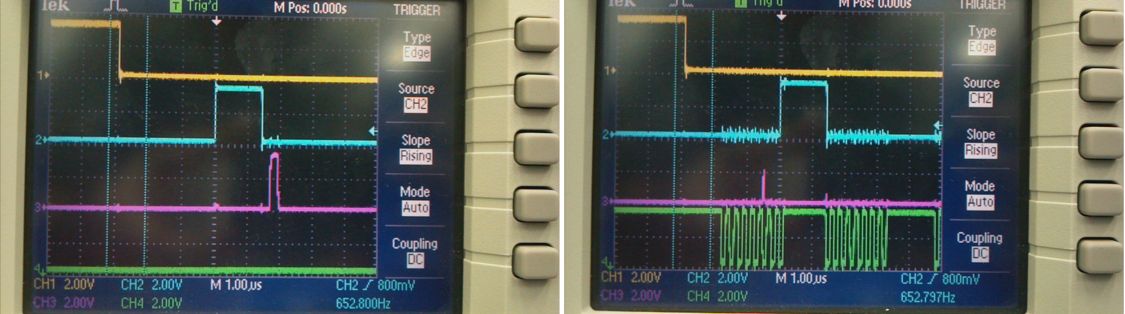

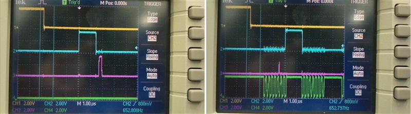

I am using the TDC7200EVM with the MSP430F5529LP. I have the GUI working fine, but I am trying to read the data using Energia code, which uses Arduino coding and SPI library. So far I have not been able to get anything but zeros from the chip.
My program sets the enable pin (P6.5) high then goes into this loop.
void loop() {
digitalWrite(chipSelectPin, LOW);             //begin comm by pulling CS low
SPI.transfer(0x10);                                       //send register byte
dataIn1 = SPI.transfer(0x00);                    //send dummy bytes and recieve first data byte
dataIn2 = SPI.transfer(0x00);                     //second data byte in
dataIn3 = SPI.transfer(0x00);                     //third data byte in
digitalWrite(chipSelectPin, HIGH);            //close comms
I've experimented with setting the OSC Enable pin (P1.6) high, but without any effect.
The data looks like it is going out fine, but there is no response from the TDC7200.
The clock signal goes out P2.2(green), MISO/DOUT is on P3.1(pink),  MOSI/DIN is on P3.0(blue), and CS is on P2.2(yellow).
  Any idea what I am doing wrong?

  • I tried reading register 0x01 and got 0x40 back. I did run into a problem where the signal disappeared if I probed the clock pin. Scope image below.
    I tried to read 0x10 again and saw a return signal, but it disappeared when I changed the code to display the value. I haven't been able to get it back.

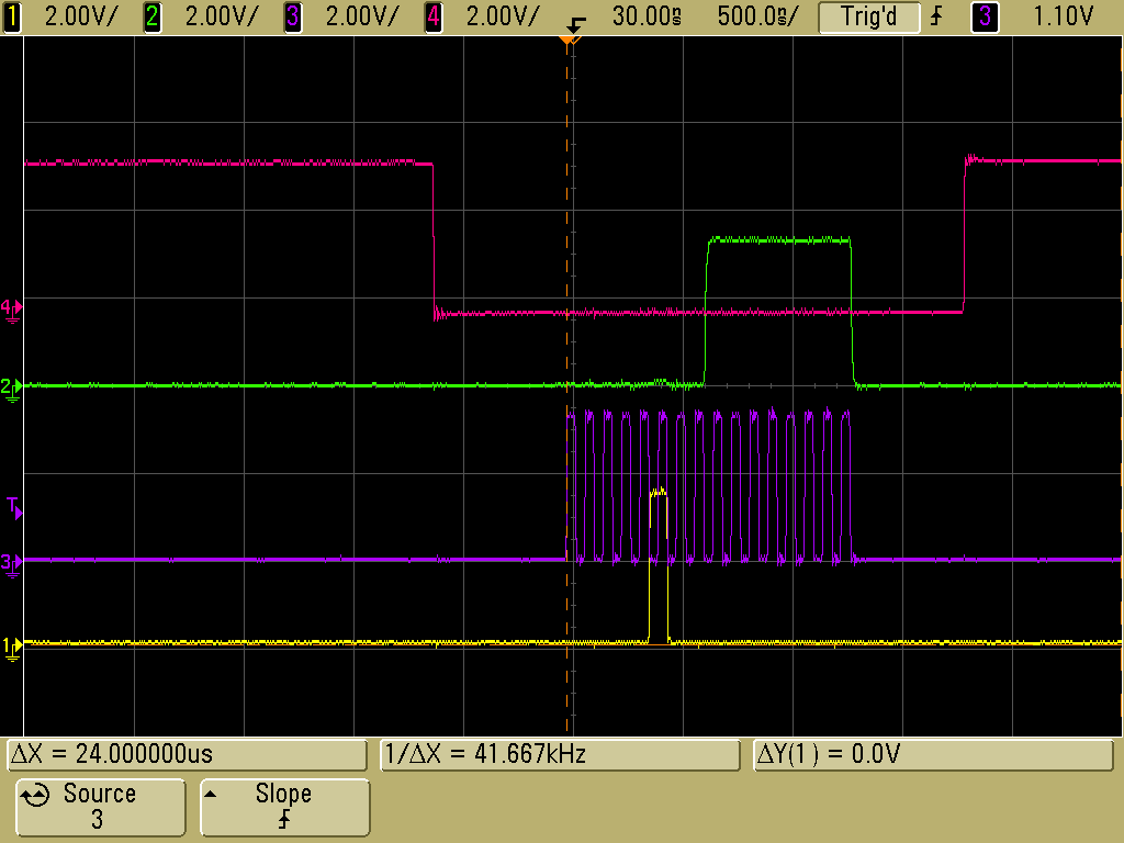

    a) Please check ENABLE pin of TDC7200 is set logic high. Otherwise, device is in low power mode and would not respond to SPI access
    b) I have enclosed below a sample SPI read waveform: reading default value (0x0F) of register 0x04
    Please check SPI clock phase/polarity selection in your code.
    Vishy
  • Vishy, I can read register 0x04 fine. My scope looks about the same as yours. One question: isn't your screen showing 0xFF rather than 0x0F?
  • Yes, default value of 0x04 register is 0xFF. Thanks, Vishy

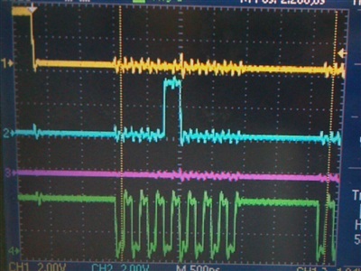

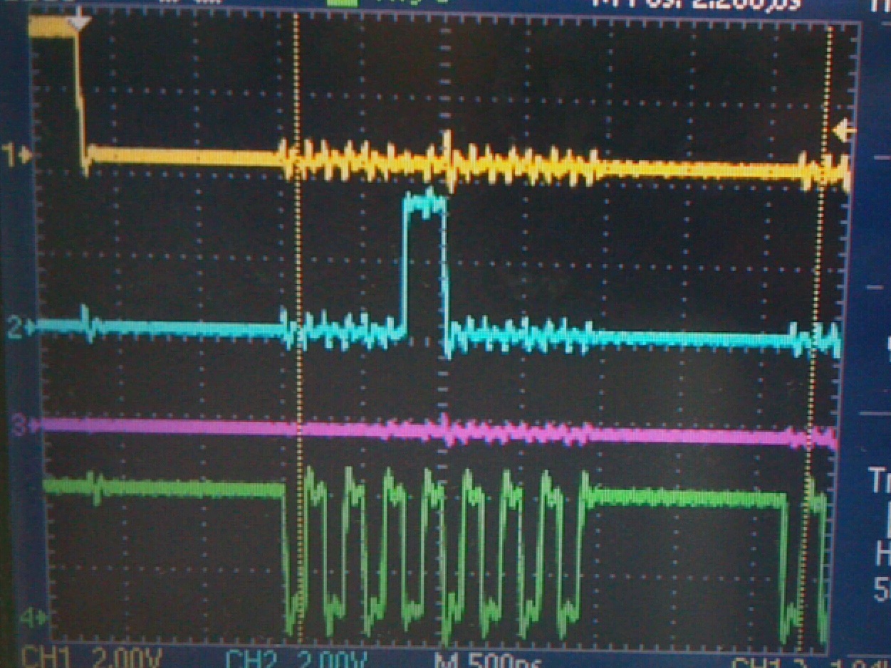

    I write a 1 to the START_MEAS bit, wait for INTB to go to zero, then read register 0x10h.
    One thing that I have noticed is that I read "FF FF FF" from the TIME1 register if I am not probing the MISO pin, but it drops to "00 00 00" when I connect a probe. Seems to me like the TDC is not driving the MISO pin for some reason.
  • I finally got this to work by abandoning the LaunchPad board and going straight to an FPGA board. I never got a very clean signal from the LaunchPad, so I suspect that the signal was just too noisy.
