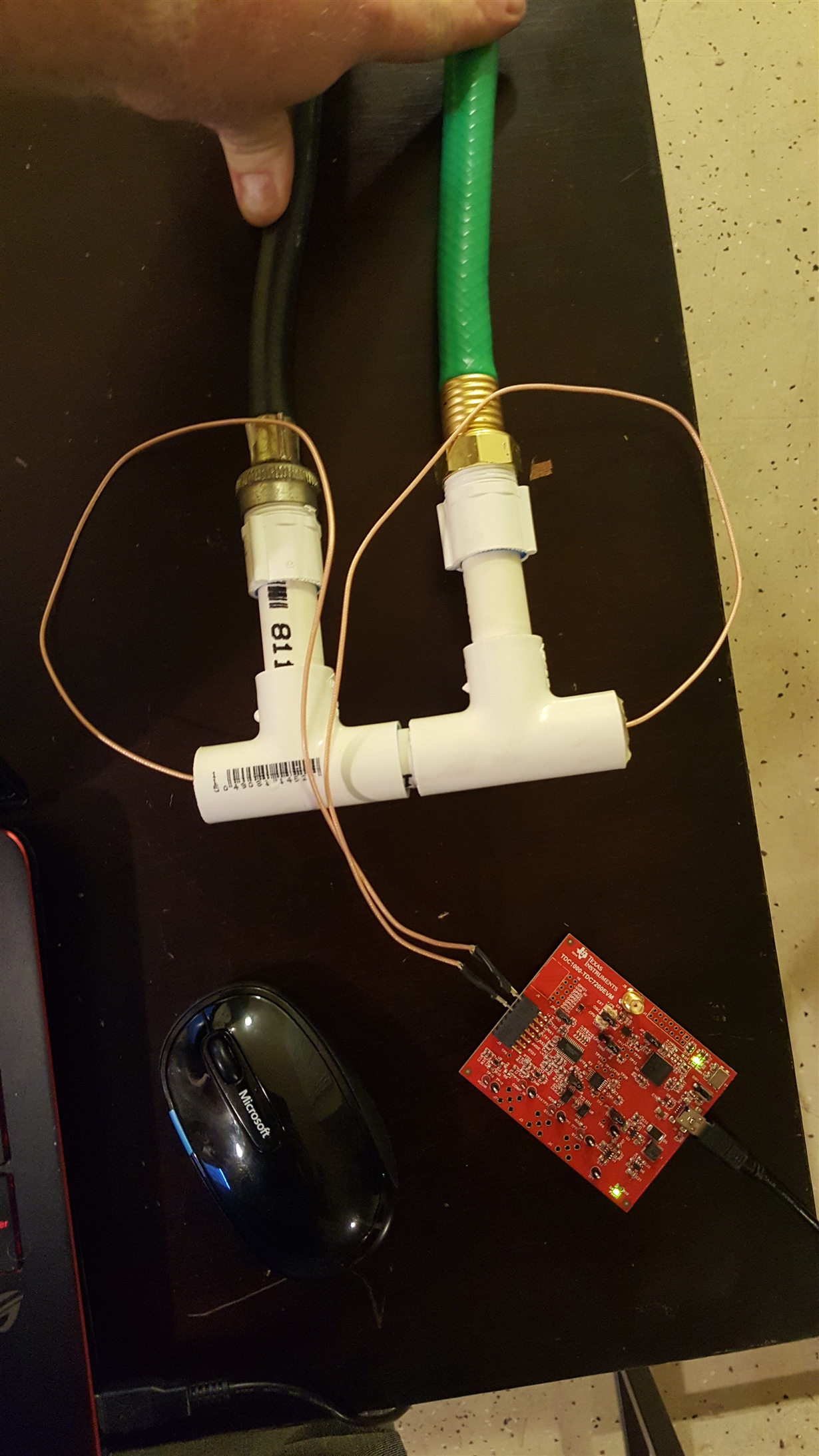

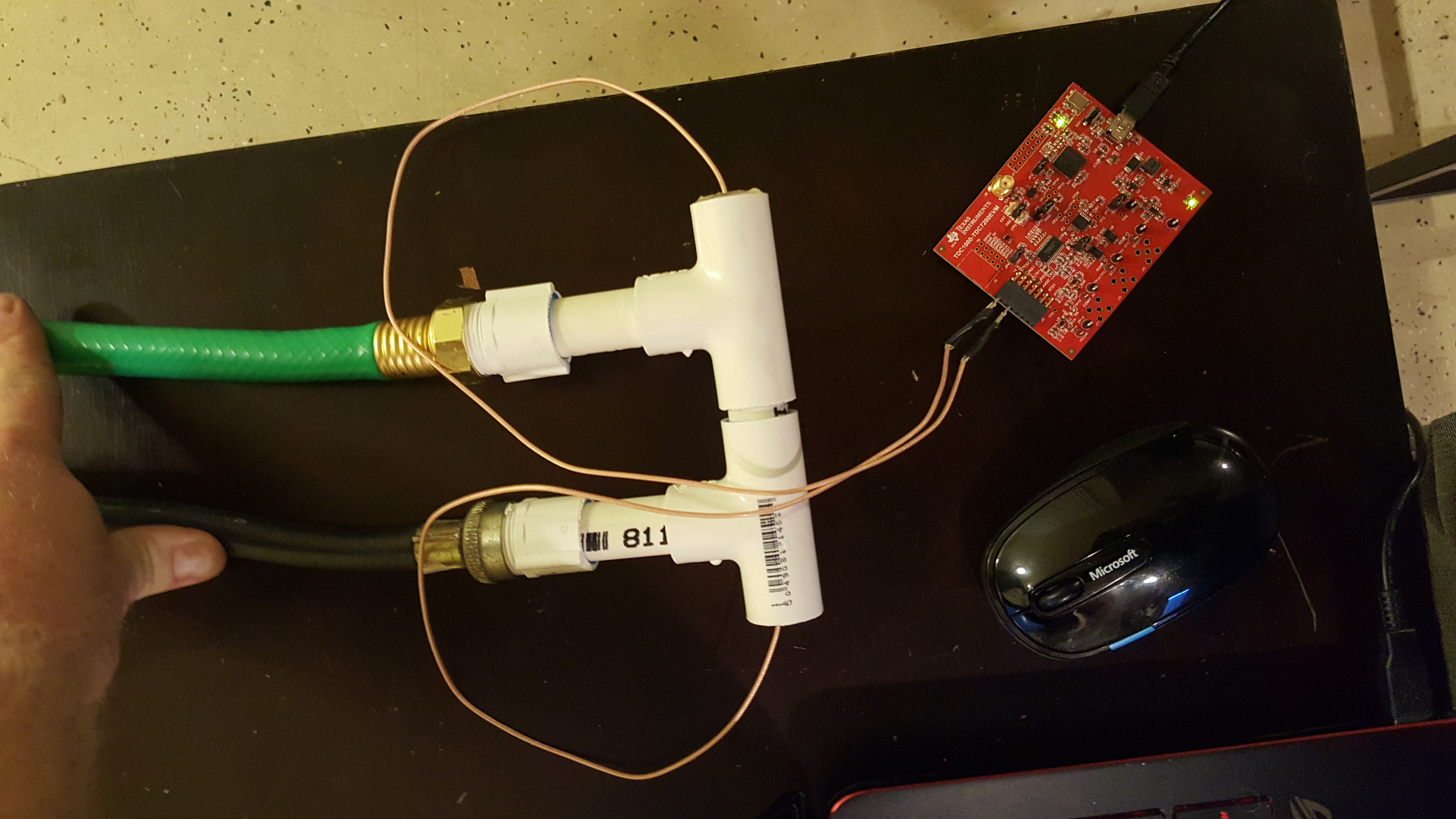

I have gotten an in-line ultra sonic contraption going right now. I have been able to get about 90% accuracy with this test. However, this is not accurate enough for the project I am working on. Even at no flow I am getting about 3 ns TOF when that should be 0 ns. When the flow is running at a constant rate and I run the GUI I am getting about 5 ns deviation in my TOF. Is there something I can do to reduce this deviation in the TOF? I have tried multiple setups for the configuration file and this is about the only one that works for me. Changing any of the averaging values breaks the test and makes the TOF extremely inaccurate ( says 0.3 ns for a 5 gal/min flow rate). Any help would be appreciated! Attached is a photo of the jig I have created and my config file.

  • Chris,
    I will review the config file and let you know. Usually, the two transducers (and any mirrors) alignment is done with CAD tools and precise machining. Otherwise, the echo amplitude seen by each transducer for zero flow could be different resulting in tof differences.
    Vishy
  • The transducers fit pretty tightly into the 1/2 pvc although there could possibly be a little movement from parallel. What kind of tolerances are there for the alignment 1° or .01°? I have a CAD file and can 3D print but if the pvc isn't straight enough a 3D print job possibly isn't either. Do I have to get this machined?
  • Chris,
    I reviewed the register settings. Please change TDC7200 config2 register value to 0x44 so the number of stops selected is 5 (same as TDC1000). In the graph tab, then you can use "TDC_SELECT" to choose a different STOP or average of the START-STOPxxx to improve accuracy.
    Sorry, we don't have experience in sensor alignment and construction as we used mainly off the shelf sensors.
    Vishy
