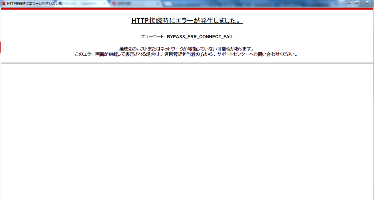

FDC2114 evm using the launch Sensing Solutions EVM GUI and comes out the following message.
An error occurred during the HTTP connection.(Textual Japanese)
Error Code: Bypass_ERR_Connect_Fail
Currently, do you know a workaround for it but the other does not have the only way to restart the PC way to return?

  • Hello Rachel-san,
    I'm sorry to late reply.
    The actual error indication is this.
    English translation is as described in previous question.
    I use EVM GUI ver.1.8.8.
    OS:Windows 7
      64bit operation system
    Do you have other possible causes?
    For example security software?
    Y.Hasebe

  • Hello Rachel-san,
    Thank you for your reply.
    I do not know whether the cause is security software.
    I have never tried running it as an administrator for this EVM.
    So I have tried running it as an administrator at first  today.
    Then there is no error occurred.
    After that, I did normal startup instead of executing administrator.
    No error has occurred.
    I will check again next week.
    Y.Hasebe
  • Hello Rachel-san,
    I confirmed the launch of the GUI yesterday and today, but no symptoms appeared.
    So, I will try using it for a while.
    Thank you for your kindly support.
